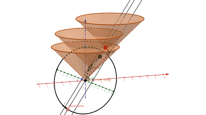

I thought it should be possible to draw a Minkowski space-time diagram that shows the light paths within the Michelson and Morley experiment.
https://en.wikipedia.org/wiki/Michelson%E2%80%93Morley_experiment
However, I am not able to make it work. So I wonder what is wrong with the diagram.
I have tried to draw a simplified diagram depicting the original Michelson experiment. I am only looking at the paths from the beam splitter to the mirrors at the end of the arms and back,
Below, you can see the following: A space-time diagram with two space axes (x andy) and one time axis (z).
There are three world lines: One going through the origin representing the position of the beam splitter (labeled b in the above picture). And two world lines representing the mirrors at the end of the arms (i.e. c and d in the above picture). These world lines go through the points (1,0,0) and (0,1,0).
I have three light cones: The bottom light cone depicts the event when the light is split at the beam splitter. The other two light cones "start" where the world lines of the mirrors intersect with the bottom light cone. These events are the reflection of the split signal at the mirrors. These two light cones include the signals returning from the mirrors to the beam splitter. At the points, where the world-line of the beam splitter intersects with these two light cones, are the fat red and black points. These points show where the light signal returns to the beam splitter.
Before I started to draw, I expected that the two endpoints of the light paths should coincide in one space-time event. However, as you can see they don't.
So this is my question:
Why is the diagram not showing the expected results, i.e. that both light paths end in one single event?
What adjustments are necessary to make the diagram work?
You can look at the original GeoGebra diagram here: https://www.geogebra.org/classic/mvxawhdx
To accelerate the system, move the red point at the bottom labeled "speed handle" to tilt the world lines of the system.

  • The reason that the reception events do not coincide is that
    your apparatus does not feature length contraction.
    Your longitudinal arm's worldline always meets the event [itex](x,y,t)=(1,0,0)[/itex].
    The signal along the longitudinal arm takes too long (compared to that of the transverse arm)
    to return to the moving source. The longitudinal arm is too far away for the receptions to coincide.
    Hence you have a velocity-dependent time-difference between receptions.
    Since this time-difference was too small to measure directly,
    an optical method using interference was used... hence the "interferometer".
    So, this setup of the arms is the expected behavior of Michelson-Morley apparatus
    according to pre-Special Relativity.
  • To have the reception events coincide (as suggested by the results of the experiment),
    length contraction of the longitudinal arm is needed.
    Your longitudinal arm's worldline should meet the event [itex](x,y,t)=(1/\gamma,0,0)[/itex],
    where [itex]\gamma=\frac{1}{\sqrt{1-(v/c)^2}}[/itex].

Obviously something's wrong because the reflected rays should return to the beam splitter simultaneously in all frames if they do so in the rest frame, but it's impossible to say what you've actually done (Edit: unless you know more about Geogebra than I do, as @robphy apparently does).
If I were you, I'd extract the coordinates of the reflection and arrival events for a couple of speeds and crank out the correct answers by hand. Then you can see which, if either, of your rays is correct.

Hm, but for the Michelson-Morley experiment the light cones are crucial, aren't they?
geogebra is a great tool also for Minkowski diagrams, but as you say, (1+2)D diagrams are not very illuminating (at least not to me), and (1+3)D ones completely out of imagination.
Sure, and I assume OP has found the reflection events by intersecting the mirror lines and the cones. But do you need to display the whole cone? Isn't the worldline of the light along each arm (plus its projection on the t axis and the xy plane) enough?
I think so.
@robphy Thanks a lot. Your hint that I must consider the length contraction on the arm in the direction of movement. I was somehow thinking that all effects such as the length contraction (and time dilation) spring automatically from the diagram. However, I missed that this is different when I consider a moving object in a stationary frame of reference.
Your example also gave me some ideas of what I can improve in using GeoGebra. Thanks for both.
@vanhees71 and @Ibix Thanks also for your consideration. The point of my question was really: What was wrong with my diagram in terms of construction. I agree with you that a 2+1 Monkowski diagram especially with the full cones is not easy "to see through". However, this exercise was for me personally to prove/see, that the Minkowski diagram can be used to depict the M&M experiment. Before going 2+1 I had tried to depict the experiment in a 1+1 Minkowski diagram but that did not work.
I found the reflection points on the world lines using the cones and when I worked on the diagram, I switched the cones on and of because they were in the way. I think for demonstration purposes @robphy 's diagram is better, where you can switch on and off the cones using a button and more transparency.
I think the 2+1 representation of the M&M experiment is a good way to show, what happens to objects that move through space. In a 1+1 diagram, it does not become as obvious, that objects flatten.
The correction of my error has been my personal epiphany regarding length contraction. From all the barn-and-pole and train-and-tunnel examples I never quite got it. Now I think I have understood and I imagine how objects become shorter as they move faster. Before I was still thinking, that the length contraction was an effect resulting from perspective and signal delay.
