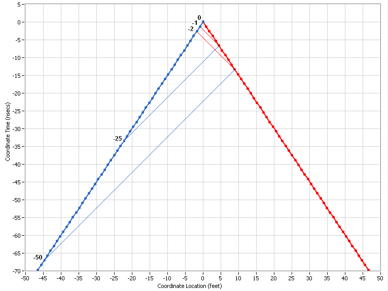

2) It also got me thinking about what would happen if two objects were moving towards each other at, say, 2/3 the speed of light. Wouldn't each appear to the other as moving faster than light?

Here's a spacetime diagram showing two objects (or observers) approaching each other at 2/3 the speed of light. I'm using the speed of light as one foot per nanosecond to make things easy. Since each observer is traveling at 0.667c in this Inertial Reference Frame, their Proper Time is dilated and takes longer than the Coordinate Time as shown by the spacing of the dots which represent one-nanosecond intervals of Proper Time:
In order for the blue observer to measure the speed of the red observer relative to himself, he can send out radar signals that hit the red observer and reflect back to himself. He notes the time he sent each signal and the time the reflection got back to him. This allows him to measure a distance applied at a particular time and by doing this twice, he can calculate the speed of the red observer.
Let's see how this works:
The blue observer sends out his first radar signal at his Proper Time of -50 nsecs and receives its echo at -2 nsecs. He calculates the average time between those two events which is -26 nsec. He assumes that the signal spent half its time getting to the red observer and half its time getting back and since it was gone for 48 nsec, he assumes that the red observer was 24 nsec at the speed of light away or 24 feet away from him at his Proper Time of -26 nsecs.
He does a similar calculation for his second radar signal which he sent out at his Proper Time of -25 nsecs and received the echo at -1 nsecs. He calculates the average time between those two events which is -13 nsec. He again assumes that the signal spent half its time getting to the red observer and half its time getting back and since this time it was gone for 24 nsec, he assumes that the red observer was 12 nsec at the speed of light away or 12 feet away from him at his Proper Time of -13 nsecs.
Now to calculate the speed, he takes the difference between the distances divided by the difference in the times. The two distances were 24 and 12 feet with a difference of 12 feet. The two times were -26 and -13 nsecs with a difference of -13 nsecs.
Thus, he has determined that the speed of the red object is 12/-13 feet per nsecs relative to himself. The negatives sign means that he is coming toward the blue observer. The fraction evaluates to -0.923c.
Now we can transform the coordinates of this IRF into one moving at 0.667c which will show us the rest frame of the blue observer:
Now the calculations that the blue observer made of the red observer's speed are more obvious but no better than in the first IRF. I didn't bother to label any of the Proper Time dots for the blue observer since they always match the Coordinate time.
Does this help answer your question?
