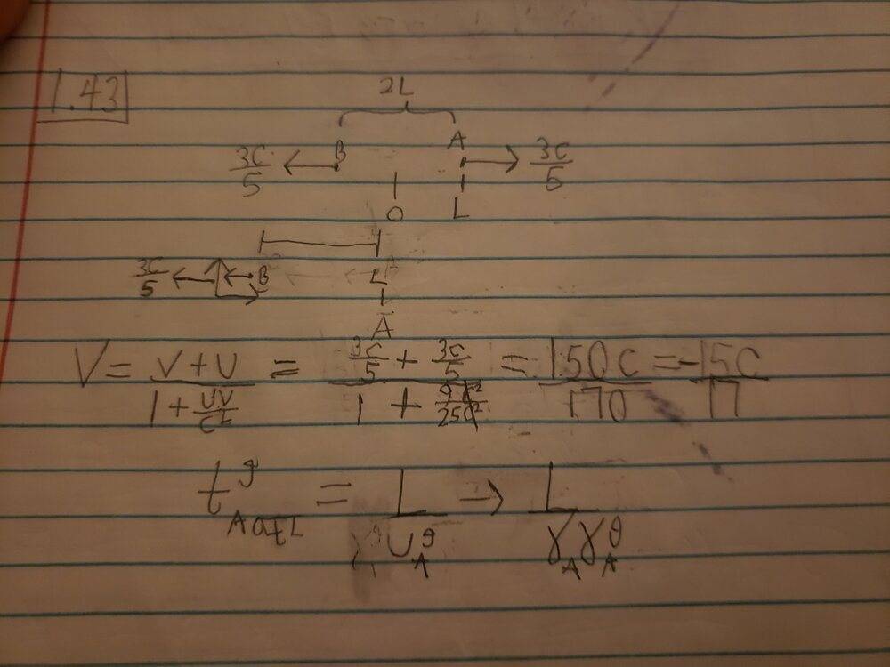

A and B both start at the origin and simultaneously head off in opposite directions, each with speed ##\frac{3c}{5}## with respect to the ground. A moves to the right and B moves to the left. Consider a mark on the ground at ##x = L##. As viewed in the ground frame, A and B are a distance ##2L## apart when A passes this mark. As viewed by A, how far away is B when A coincides with the mark?
$$t_{observed} = \gamma t_{proper}$$
$$L_{observed} = \frac{L_{proper}} {\gamma}$$
$$t_R - t_L = \frac{Lv}{c^2}$$
$$V = \frac{u+v}{1+\frac{uv}{c^2}}$$
I don't know why I'm so puzzled by this problem; it's only one star. So first, I drew a picture of A and B in the ground frame. Then I drew B and the ground in A's frame. I then used the velocity addition formula to obtain the velocities of both B and the ground relative to A.
$$\frac{v_{B}^{A} + v_{gound}^{A}}{1 + \frac{v_{B}^{A} v_{gound}^{A}}{c^{2}}} = \frac{-\frac{3c}{5} - \frac{3c}{5}}{1 + \frac{9}{25}} = -\frac{15c}{17}$$
And I don't where to go from here.

What is time reading of A's clock when A is on the mark ? Then multiply it with the velocity you calculated.
I got ##V_{B}^{A}t_{A}^{ground} = \frac{25L}{17}##. So wait, that's the answer? We don't have to take into account time dilation?
That can't be right. You must use time from A's frame.
Ah! Now I see! The mark ##L## is part of the ground frame, so in A's frame, the distance between the origin and ##L## will be contracted! So the time it takes for A to coincide with ##L## in A's frame is $$\Delta t_{A at L} = \frac{\frac{L}{\sqrt{1-\frac{9}{25}}}} {-\frac{3c}{5}}$$. But this gives me a negative time.
I don't understand that calculation.
Why not stick with your original plan to calculate ##v_B\Delta t_A##, where ##v_B## is the speed of ##B## and ##\Delta t_A## is the elapsed time both in ##A##'s frame?

That is what I'm going to do. I'm just trying to get ##\Delta t_A## first. I'm treating the ground in A's frame as almost like a train with proper length ##L##. So then I can calculate the proper time of A ##\Delta t_A## when it coincides with the back of the "train" (i.e ##L##). Is what I'm trying to do nonsense? Please let me know.
That's fine. In A's frame the origin and the point at ##L## (in the ground frame) are length contracted. Imagine a marker at the origin and another at ##L## in the ground frame. That marker is moving in ##A's## frame and takes ##t_A## to reach ##A##.

Yup, that's exactly what I'm trying to do. But I'm still getting a negative time from the velocity of the markers in A's frame.
That's silly! You have a distance divided by a speed. There should be no negatives involved.
I'm getting -25L/12c.
What would you do if this was a non-relativistic problem? Would you still get negative time?
No, because then I wouldn't be taking into account sign of the velocity. I would just be dividing by the speed. The markers are moving to the left at 3c/5, thus, -3c/5. I then divide ##L/\lambda## by the aforementioned velocity which gives a negative value.
Why do you only take into account the sign of the velocity because it's SR? You're saying that if the speed is ##10m/s##, then you use ##10m/s## and if it's ##1km/s## you use ##1km/s##, but at a speed of some significant fraction of ##c##, you switch to a negative speed?
At what speed do you switch from from positive to negative speeds?
If you want to use velocity, which may be negative, you must use displacement, which can also be negative.
Yes. Sorry, I confused the frames. ##\Delta t_A## is therefore ##25L/12c##. ##v_{B}^{A} \Delta t_{A} = (-\frac{15c}{17})(\frac{25L}{12c}) = 375L/204##.

I'll show how I would approach this problem. One option, of course, is to apply the Lorentz Transformation. Alternatively (I'll use ##v## as a fraction of ##c##, sometimes called ##\beta##):
First, in A's frame at ##t_A = 0## the point at ##L## is a distance ##L/\gamma## away. And, moving towards ##A## at speed ##v##. It reaches ##A## after time ##\Delta t_A = \frac{L}{\gamma v}##.
Meanwhile, B has been moving away from ##A## at speed ##v_B = \frac{2v}{1 + v^2}##. Hence is a distance:
$$d = v_B \Delta t_A = \frac{2L}{\gamma(1 + v^2)}$$
Now you can plug in whatever ##v## you've been given.

Is that gamma associated with the speed of A, B, or ground, and in which frame? That's what I'm confused about right now.
##\gamma## is associated with speed ##v##.
I'm getting 125L/68. That doesn't seem right.
I agree it doesn't look right.
Let me show you one advantage of my method. (I'm very anti plug-and-chug for this reason). I got:
$$d = \frac{2L}{\gamma(1 + v^2)}$$
And I can sanity check this formula. If ##v## is non-relativistic, i.e. ##v \approx 0## and ##\gamma \approx 1##, then we get ##d = 2L##, which is the correct non-relativistic limit.
Also, as ##v \rightarrow c##, we get ##d \rightarrow 0##. Which, if you think about it makes sense.
That doesn't mean my formula is right. But, all you have are numbers that tell you nothing about the physics.
All you have is ##125L/68##, which tells you nothing about the physics of the problem.
In any case, how did you get that number?

I actually did the gamma wrong. Now I'm getting 4L/17. I did the following: $$v_{B}\Delta t_{A} = \frac{2L\sqrt{1-\frac{9}{25}}}{1+\frac{9}{25}}$$.
Amrator said:
I see.
$$\frac{2L\sqrt{1-\frac{9}{25}}}{1+\frac{9}{25}} \ne \frac{4L}{17}$$.
Right, arithmetic mistake. Now, I'm getting 20L/17.
