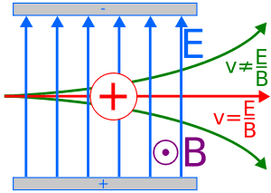

First, I had to understand what a velocity selector is.
Here is a clear picture from Wikipedia:
Indeed, the solution boils down to calculating the velocity of a beam of electron at the energy of 5.104eV.
The energy is related to the speed by this formula:
Solving, you should find v/c = 0.412687
