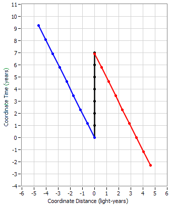

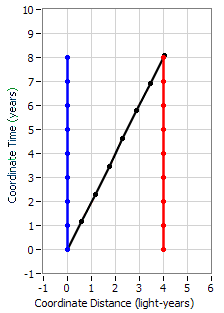

I'm with TumblingDice on this one, especially if you make some spacetime diagrams which will make it obvious that in the mutual rest frame of the two planets, the space ship's time is "spread out". Here the two planets are depicted in blue and red while the spaceship is shown in black. The dots mark of one-year increments of Proper Time for each object:
Now we can use the Lorentz Transformation process to see what the same scenario looks like in the rest frame of the spaceship during the "trip":
As you can see, now it is the planets' times that are dilated. And you can also see the distance between the planets in this frame is contracted from 4 light-years in the first frame to just under 3.5 light-years.
However, you said that the guy on the spaceship makes measurements and these diagrams don't show how he makes those measurements. Have you considered how he might make those measurements that would agree with the information depicted in the diagrams?
