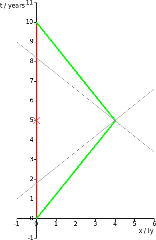

Let's do some maths. The real numbers are complicated, time varying, and messy. So I'm going to do this with a constant distance of 1ly (in the Earth frame) and a transit velocity of 0.8c, implying ##\gamma=5/3##. The traveller sets off at time zero. With those numbers he arrives at "Mars" 1.25 years later having experienced 0.75 years of time.
According to the Earth frame the stay-at-home has aged 1.25 years and the traveller 0.75. But this cannot be verified directly! It can only be verified by asserting that clocks on "Mars" are synchronised with clocks on Earth and comparing the traveller's clock to the local ones (or some equivalent process involving actually communicating).
Other frames do not agree that the clocks are synchronised. They agree that the time when the ship left was zero. They agree that the traveller's elapsed time was 0.75 years. But they do not agree with the procedure for comparing the traveller's age to the stay-at-home's - the clocks are out of sync.
A frame moving at ##v## (with gamma factor ##\gamma_v##) will say the arrival event occurs at time ##t'=\gamma_v(1.25-v/c)##, at which time the Earth is at ##x'=-v##, implying an elapsed time on Earth of ##t=\gamma_v(\gamma_v(1.25-v/c)-v^2/c^2)##, which implies an age difference of ##\gamma_v(\gamma_v(1.25-v/c)-v^2/c^2)-0.75##, which is clearly frame dependent.

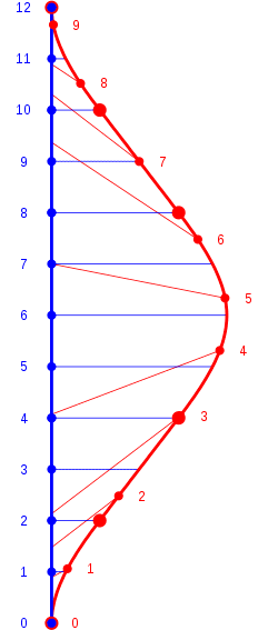

There are a number of problems with your analysis in this thread. You have a problem here:
Consider a third traveller, who accelerates very rapidly, then decelerates very rapidly without having traveled very far from Earth. The acceleration and deceleration phases could be identical to those of a space traveller, who continued at their cruising relativistic speed for some time (before decelerating).
This third traveller will have experienced minimal differential ageing despite having experienced the same acceleration and deceleration as the space traveller.
This shows that nothing special happens during an acceleration. There is no rapid ageing.
The differential ageing is entirely a function of the time spent traveling at relativistic speeds (*).
(*) PS More generally, it depends on the entire path through spacetime; and not on the periods of acceleration.

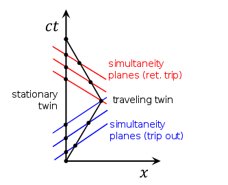

Is a twin that takes off to Mars to stay, younger than a stay at home twin or is it ambiguous?
The ambiguity (“incomplete specification” might be a better term) will be easier to see if we rephrase the question. Both twins zero their clocks while together on earth, and then Mars-twin starts their journey. On arrival, Mars-twin looks at their clock and sees that it reads ##T##. You are asking whether at the same time that Mars-twin’s clock reads ##T##, Earth-twin’s clock reads something less than ##T## (Earth-twin is younger), greater than ##T## (Earth-twin is older), or the same (both twins still the same age).
Clearly the answer depends on how we define “at the same time”.
I would think that this could be determined simply by sending the current time to each other and subtracting the data travel time using distance and c, determining in this way if the Martian's clock had slowed.
That is one sensible way of defining “at the same time”. In effect we are taking the reading on Earth-twin’s clock when the signal from Mars reaches Earth, subtracting the light travel time, and we have the time on Earth-twin’s clock when the signal left Mars. Using this definition and with your sensible simplifying assumptions (“the relative velocity between Earth and Mars is 0 and am ignoring any gravitational effects”) we will find that Mars-twin is younger.
However, suppose I am moving relative to Earth and Mars and I try using the same technique for comparing the clock readings (receive signals from both twins reporting their clock readings, subtract light travel time to determine when signal was sent) I will get different answers and may even find that Earth-twin is younger. There’s no paradox here, it’s just that my definition of “at the same time” will be different from that of someone who (as are the twins) is at rest relative to Earth and Mars.

Yes, in a frame where the Earth-Mars system was moving (in the direction towards the Earth) then the traveller would be seen to decelerate to a slower speed, before accelerating back to the same speed as the Earth-Mars system. In this frame, more time would have elapsed on the traveling clock than a clock on Earth or Mars.
In that reference frame, the twin that traveled to Mars would be older.
