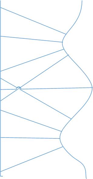

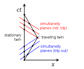

Here's a simple one.
It's overly simplified because it illustrates infinite acceleration. (the traveling twin's path is not curved, as it would be with realistic acceleration).
That's important, because realistic acceleration means that in reality, the red and blue lines will not intersect at the midpoint - so there will be no "jump" from blue to red - it is smooth, if rapid.
Ah. This one is more realistic:
Notice that the change from red to blue EDIT: blue to red occurs exactly when the traveling twin turns around. That is when he is accelerating. This is the Minkowski diagram representation of acceleration.
FactChecker said:
Notice that the change from red to blue occurs exactly when the traveling twin turns around. That is when he is accelerating. This is the Minkowski diagram representation of acceleration.
See second diagram. Acceleration is not instant.
Note also that deceleration and negative acceleration (back toward Earth) are the same thing.
Mars-bound traveler actually beings accelerating at point 3, not at the midway point 4.5.
I am trying to say that all these approaches fit together and are not in conflict. When something is true, it can often be looked at in many consistent ways. The Minkowski diagram includes representations of changes in velocity (accelerations). To say that accelerations do not play a role is to say that these Minkowski diagrams are wrong.
The first diagram is indeed wrong. It illustrates infinite acceleration (for simplicity).
The second diagram is the correct one.
And his acceleration (toward Earth) actually begins at point 3, not the midpoint.

The net effect is thus:
  1. M and E age at the same rate while at Earth.
  2. As M accelerates away from Earth, he will observe E aging slower.
  3. If he shuts off his engines, E will continue to age at the same slow rate.
  4. As he begins his decel (acceleration toward Earth) nearing Mars, E's slow aging will lessen until he is aging at a normal rate.
  5. As M continues to accelerate (toward Earth) it reverses his course and E's aging will accelerate, now starting to appear slightly older.
  6. As M continues to accel toward Earth, E will continue to age rapidly until M starts his decel.
The upshot is that, when M begins his acceleration, E continues to age slowly, even though the slowness begins to decrease.

All lines on the return trip are diagonally going NW to SE (i.e. E is aging faster than M):
(I see that there is a "missing feature" in this diagram. It's not wrong, it's just not easy to plot it on a timeline).
I was writing up a description:
"Earth-Mars Return trip, 12 months Earth time, 9 months ship time"
and planned to describe each point of the traveller's journey as if they are months.
But The traveller is not checking his clock at regular intervals! His checks (0,1,2,3,4,5,6,7,8,9) are not evenly spaced. eg. the passage of time between traveller's 4 > 5 and 6 > 7 are of quite different durations. :frown:
