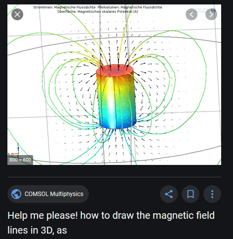

I didn't intend to say it has to be empirical. These kind of problems are usually solved using FEA sotware packages like COMSOL. You didn't seem to have any intuition for the situation, so that's why I used the battery in a conductive fluid analogy to try to get you started.
Have you used COMSOL Multiphysics or any other FEA packages yet?
Thanks, I have Maxwell SV, which comes up with 'a number' if I put in permanent magnet material.
I was hoping there would be some 'known' canonical solution, like reluctance outside a bar magnet being a function of its dimensions, length and cross-section/pole areas basically, not sure what else it'd be a function of?
