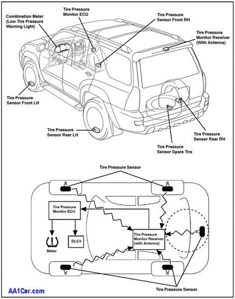

Many times, when I am driving my car, I worry about the tyre pressures. Why can't I have a gauge or friendly light to tell me they're ok? In my head, I have designed many different systems for the measurement and the telemetry. I realize it isn't 'very easy' but there's no reason it can't be done. Why isn't it marketed to people as another 'peace of mind' gizmo? It's far less smart than automatic parallel parking!
It already exists...
I have them on my Chrysler. They broadcast to my heads-up display and tell me when the pressure in each tire is low or high.
It is commonly called TPMS, for Tire Pressure Monitoring System.

Does anyone know how the sensing is done and what the telemetry system is? I found some fairly generic stuff on Wiki etc. but what about the details?
I like the indirect method of comparing wheel speeds.
two types of monitoring systems
direct reading – small transmitter is attached to tire valve stem and directly reads pressure of the tire. if psi changes it will alert the dash board light. has to have unique code so other vehicle s with this type monitoring system will not false trigger your dash light. cost is about $100 each form manufacturer though after market replacement transmitters are half the price. these are subject to damage if you buy a new set of tires and the local tire gorilla operating the mechanical mount/dismount tire changer is not careful.
Indirect reading systems – use the ABS (anti lock brake ) sensor on each wheel. If one tire has lower PSI reading it will have smaller radius and different RPM count versus the other 3 tires and will alert the dash light. pretty bullet proof can simple software to monitor.
