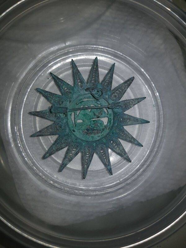

I assume that after so many years in the attic the water would have all evaporated and left the medallion encrusted with salt when you rediscovered it right? Anyway I think you should use about a 5% solution of sodium hydrogen sulfate (also known as sodium bisulfate) to remove the copper salt. This is a cheaply available powder available on the Internet with no fume problems. Even dilute hydrochloric acid can give off small amounts of corrosive fumes, but more to the point it might etch further into the copper metal in the presence of oxygen from the air and in the water and its slight tendency to form complex copper chloride ions. Even though you may have some sodium chloride ions still in the encrustation, you would be unlikely to have trouble like this by using sodium bisulfate solution which will only produce copper sulfate and not a potential mix of Cu1 and Cu2 chloride ions.

I worked in a printing circuit board shop as qc chemist. For tarnished Silver and Copper the tarnishing can be reversed and importantly the surface features are preserved. From your picture, your Copper Medallion appears corroded to where the underlying features probably no longer exist. Copper resists dissolving in strong mineral acids but I'd avoid Chloride as that's how this mess got started. Ammonia stinks but will rapidly dissolve insoluble Copper salts, and after the salts it will go after the Copper. Note that blue is the Cupric or Copper +2 compound. Copper likes to share so Cu+2 from blue solution and a Copper from surface gives 2 of Cu+1 which are favored by halogens like Chloride. The medallion could be x-rayed to determine surface damage before treatment. If it wasn't so corroded you could wrap it in Aluminum foil and put it in a baking soda or vinegar solution. Unfortunately any Copper already detached from surface is reduced to Copper powder.
As your medallion corroded, the surface is not evenly eroded but along machining stresses and imputiries (I'm curious about the pattern of corrosion.)
I would use dilute sulfuric acid (battery acid), vinegar would work eventually but its only 5% and you have pounds of crud to dissolve or loosen. Crystal Vanish or pool acid is Sodiumbisulfate (meaning half sulfuric acid) which would work.

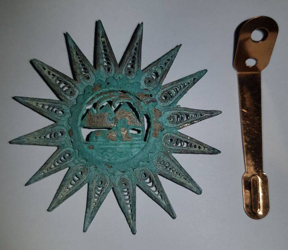

What if the medallion is composed of cooper/iron alloy? How to tell? I used magnets and it didn't stick. Are magnets supposed to work on cooper/iron/whatever alloy? The following is after using brushes, soap, vinegar scrub for 20 minutes.
Look at the copper strip besides it. When I got the medallion about 25 years ago. It didn't look like copper. After spending 5 years experimenting on it. I stored it for 20 years.
Just wondering. Can anyone make out what images are in the center? Have you seen anything like it? I want to know how rare it is or just sold in market elsewhere.
You're right - it might be a brass trinket.

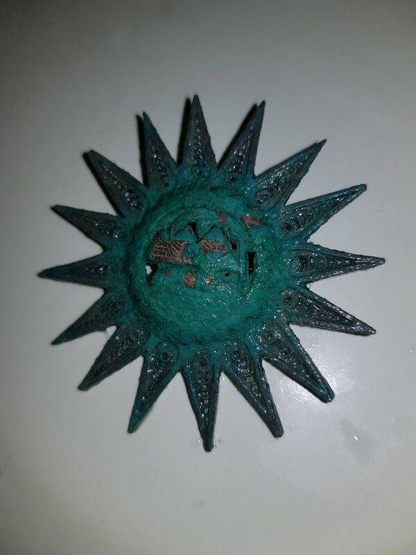

Or you could just pressure wash the thing. No chemicals. Wood and metal resist high water pressure, so the underlying copper should be OK.
Your picture showed bluish and whitish crust, the blue Copper and white could be Lead or Zinc. If it had Iron it would be rusty orange.
  • #53
This is back of it. Bluish and whitist crust? The front has green only, maybe your monitor color balance setting? And you mean it contains lead or zinc? some kind of lead or zinc alloy? Meantime I put it in a plastic container and put back in attic. I'll give it to jewelry repair shop when Covid is over and I'm confident he won't ruin it (reviewing all your chemistry tips, thanks for them). I guess Covid will be over by April or June. I need to soak it in salt water for 30 mins once in 2 months (to clean the absorbed prana). I guess shaking in pure water afterwards can loose any salt and cleaning with dry clothe would be ok to avoid more corrosion, isn't it?

Brass - Copper/zinc alloy
Bronze - Copper/tin(sometimes arsenic) alloy
Yours is probably bronze.
