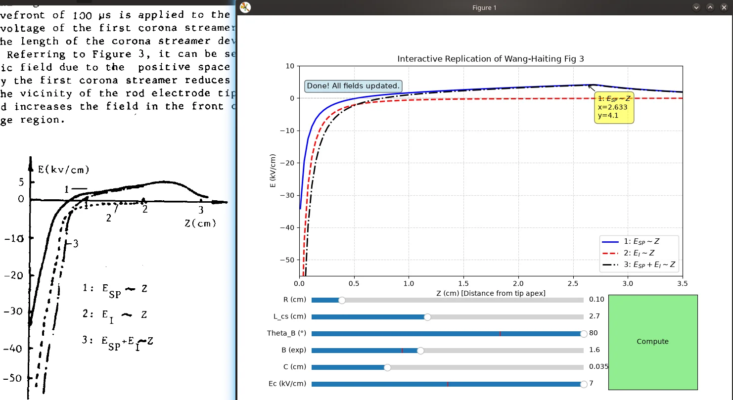

Currently, I'm trying to replicate their Figure 3: Electric field distribution in the vicinity of the rod tip owing to space charge. However, they do not provide what parameters they used for A, B, C, and θB (they tell you how to choose them). The idea is to select B and C such that:
$$E_{ext} + E_sp + E_{I} = constant$$
since the experiments showed that the total field becomes uniform and almost constant, even though the space charge field is extremely non-uniform.
In their results, they do not show how they calculated Eext (external, voltage applied to the electrode); they do, however, mention the method and have a source for it.

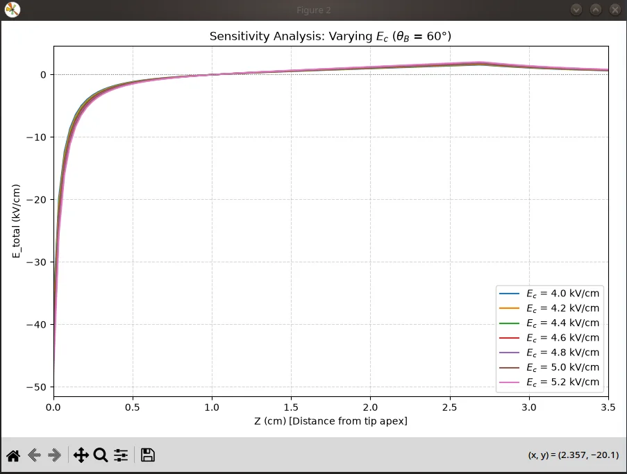

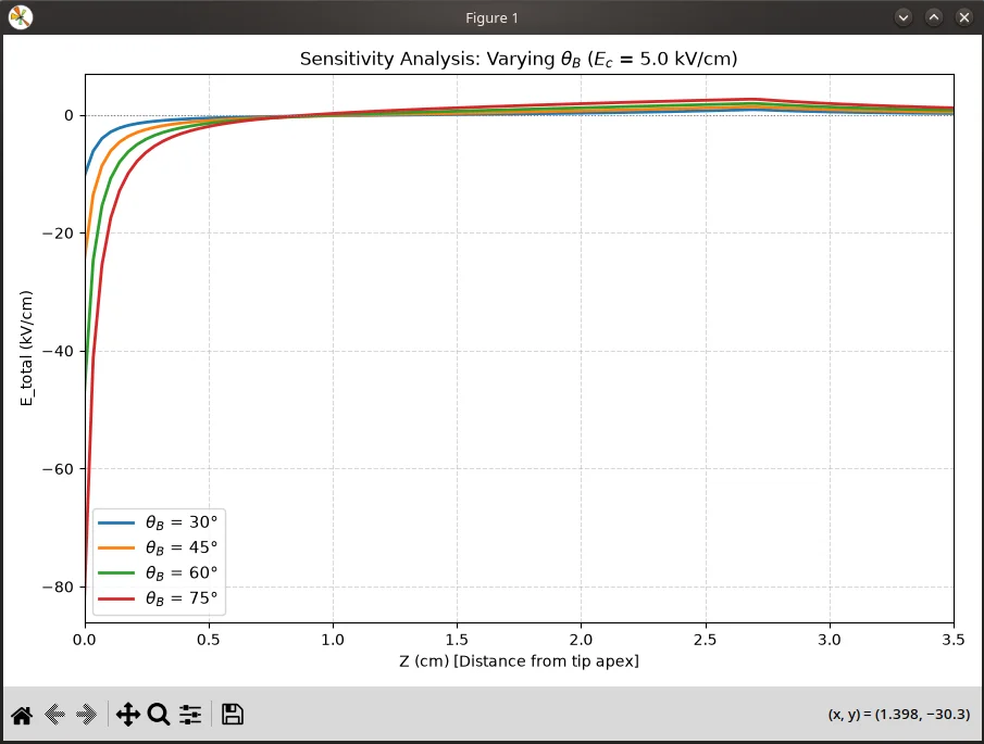

The problem is, that in my results I had to max the parameters for θB=80 degrees and Ec=7kV/cm to reach close to their data, which is probably wrong because they say they used Ec=5kV/cm.
I do not know what to do next.
Thank you for your time.
