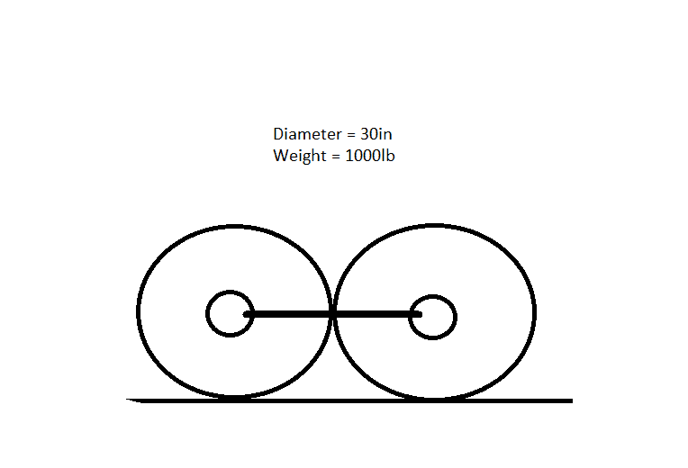

Hello, I am trying to figure the strength (in lbs) of a strap needed to attach 2 Rolls together without breaking. Each wheel has a weight of 1000lbs and a diameter of 30in. Assume each roll is a perfect circle.
Hello, I am trying to figure the strength (in lbs) of a strap needed to attach 2 Rolls together without breaking. Each wheel has a weight of 1000lbs and a diameter of 30in. If there is required information missing, let me know.

They are big rolls of plastic sheets. They are usually sitting there but I wanted to know the breaking strength of the straps (in lbs) needed in order to prevent them from separating as they will eventually be shipped via trucks.

What would cause any side-to-side motion that would stress the strap? How are the rolls packaged for lifting into the trucks? Why do you need to join pairs of them instead of crating several all together? How are they unloaded at the destination? Have you discussed this with the trucking company to get their ideas?

Understood. Without external forces, anything would hold them together. Now, what if the question was changed where there is a third wheel stacked on top of the other two. What forces would be acting on each wheel on the bottom.

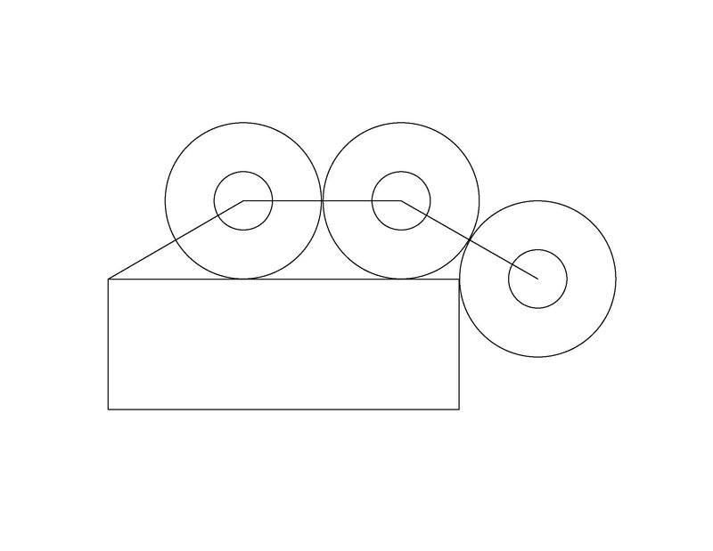

Let me try this way: describe a specific scenario you expect would cause them to separate if not strapped together.
The worst-case scenario could be one roll hanging in the air from the next one located at certain angle.
If that angle is estimated to be 45 degrees, the force on each leg of the strap should reach 707 lbs.
If that angle is estimated to be 60 degrees from vertical, the force on each leg of the strap should reach 1000 lbs.
The length of each roll should be above 33 inches.
Do you have a suitable flexible strap that can be wrapped around a length of above 130 inches (11 feet)?
You forgot to draw the little stick figure person below that roll with a very scared look on their face... :wink:
I was thinking something similar, but I don't know shipping: is there an impact scenario where they have to remain attached? What if they are shipped by air, and the g-forces from the plane have to be included?
