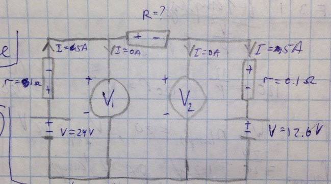

A battery of EMF 12.6 V and internal resistance 0.1 Ω is being charged from a DC source of EMF 24.0 V and internal resistance 1.0 Ω using the circuit shown in the figure below. V1 and V2 are high resistance voltmeters and R is a fixed resistor.
(a) What is the polarity of terminal A of the source?
(b) I the charging current is 5.0 A, determine the resistance of the resistor R.
(c) If the resistance of R were changed to 0.9 Ω what would be the reading on each voltmeter?
Answers: (b) 1.18 Ω, (c) 18.3 V on V1 and 13.2 V on V2.
2. The attempt at a solution
Every part I am in doubt whether it is correct or not.
(a) Since the battery has a polarity of + - Battery + - (of we look from the top to the bottom), I would say that the polarity of the terminal A would be negative (-). Since the current flows from the positive sign of the battery to the negative sign A of the DC source.
(b) This is only a guess: 24 - 12.6 = 5 (0.1 + 1 + R) → R = 1.18 Ω. Maybe because the voltmeters have large resistance they don't disturb the circuit and so we just calculate the way I did (like it is a simple circuit only with two batteries).
(c) No idea.

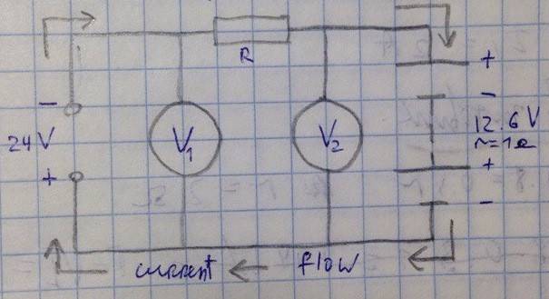

So A is negative, it goes to a positive battery, which then becomes negative again and the point below A is positive. So A is negative is correct?
Draw the circuit with the 24 V supply in place and indicate the direction of current flow. What does KVL around the loop say the current should be?
I actually think it should be from + 12.6 V to - 24 V because the long line is where current flows from it and not from the short line (that is where electrons flow from). But it was said that current flows from low voltage to high voltage.
What's the total EMF for that loop, following the direction of the current you've indicated?

24 V + 12.6 V = 0 V like this?

You have indicated a current going clockwise. So do a "KVL walk" clockwise around the loop summing up the EMFs (just the sources). Remember that when you traverse a source from its - lead to its + lead it is a gain in potential, and when you traverse it from + to - it is a loss in potential. What is the sum you get? Is it positive or negative?
So it's -24 V - 12.6 V = 0.
The polarity of your 24 V source is indicated incorrectly in your drawing, but your current's direction is correct, that is the source forces current in the opposite direction to what the battery would normally let it flow, so that the source is charging the battery.
How did you determine that?
The source needs to oppose the battery in order to reverse the current through the battery.
In other words since we want to charge the battery, we need to oppose the current flow. And since we know that current flows from + and we have + of the battery as up, therefore we put + at A (the point of the DC source), in that case current will flow from the regular + point from the source and will inversely flow into the battery and charge it. Like this?
Correct - I have added a "drawing" to my previous post.

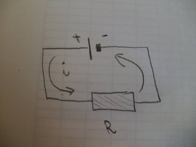

moenste said:
...the long line is where current flows from it and not from the short line (that is where electrons flow from).
If the battery is powering a load, that is true. However, if the battery is the load then current flows in the opposite direction. Considering the graphic symbol for a voltaic cell, the long, thin line represents the positive terminal, and the short, thick line represents the negative terminal.

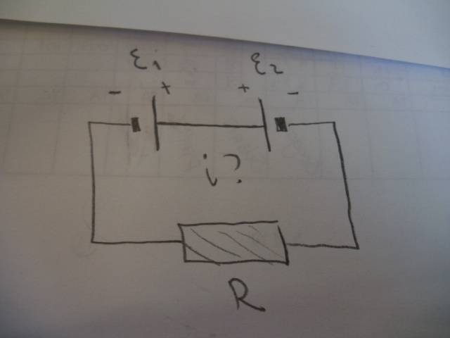

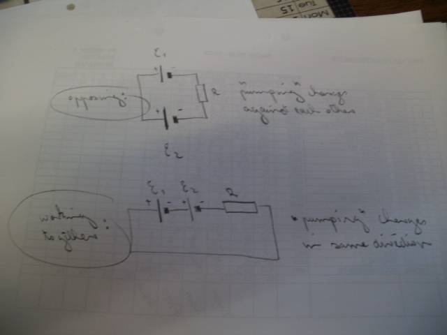

An emf source can be considered to be a (positive - conventional current) charge pumping station - that is it circulates the charge around the circuit
These two pumping stations are assisting each other, thereby adding their pumping ability or emfs
These two are opposing each other - pumping against each other
we find that whoever pumps hardest determines the direction of the current in the circuit, if E1 > E2 then the (+) charge will circulate clockwise in the circuit ...
also if E1 = E2 no current will be present in the circuit.
In the case of charging the battery we find that the battery we can restore the chemical state when the charging source forces the charge to flow in the opposite direction through the battery. This reverses the chemical reactions in the battery, something that does not work for all batteries of cause.

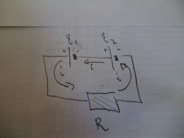

Alright, I think I got it. Since we know that the DC source is charging the battery, therefore the A point on the graph should be positive. In case we were not told that the DC source is charging the battery or that we were told that they are assisting each other, in that case we would say that the A point is negative after looking at the battery.
For (b):
As @gneill explained the KVL, this is what I got:
And so the walk is: 24 - (1 * 5) - 5 R - (0.1* 5) - 12.6 = 0
5 R = 5.9
R = 1.18 Ω... This should be correct + I do understand what I did now.

1. Correct, since they are resistors the current will pass through them anyway.
2. Correct again, since one traverses the whole of the loop it does not matter where you start, the terms will still be the same, just in a different order :)
3. Correct again, I think the intention is to show that it consists of various separate cells connected together. In the case of a 12V lead-acid battery there will actually be 6 cells I think since each one generates slightly above 2V. Many batteries consists of several cells connected in series to give a higher voltage. Open some of them if you have the inclination.
(c) the emf of each battery is just reduced by the voltage drop over their internal resistors - this is what the voltmeters indicates - the reduced emf.
The way you wrote it worries me a (little :) ) bit - not seriously though. To get the voltage V1 you just to start at the one connection and walk around to the other connection I think. That should give you the V1 voltage so that is just amounts to

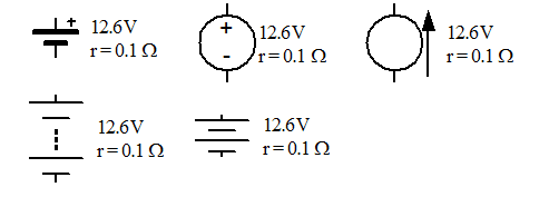

3. In the original picture we have the battery that had two long lines and two short lines and a dotted line in between. Is it OK if when re-drawing I just represent them as I did on my graph? I'm a bit confused on this part, since I didn't see anywhere a proper explanation what is the difference between just two lines (+ -) and the one that we have in the original graph. As I see it -- the battery is composed of two batteries (+ - and + -). This part is particularly important to understand since one can assume that each + - and + - is equal to 12.6 V or that we need to divide the number by two and draw + 6.3 V - --- + 6.3 V -.
There are several different schematic symbols for a voltage supply. Traditionally, the symbol for the cell (one short and one long parallel line) was meant to resemble the construction of a Voltaic Cell, a simple voltage source comprising two dissimilar metals sandwiching an electrolyte paste. A battery (or Voltaic Pile) comprised a stack of these cells, to create higher potential differences; a single unit cell typically produced about 1.5 V depending on the precise metals and electrolyte. That's why the battery symbol looks like a stack of the cell symbol.
Today there are more varied architectures for batteries, so the battery icon is more symbolic than physically descriptive, but it still has the connotation that the voltage source is meant to be thought of as a stack of unit cells of some sort.
Some voltage source symbols:
You are free to use any recognizable symbol for a given DC voltage source provided that you display the relevant characteristics in text beside it, although aesthetically the stacked cell versions lend more of an impression of a battery type device than the others. All of the examples depicted above would be suitable for a schematic diagram that you draw to analyze the circuit. Different industries tend to favor different variations for their published materials, but it's largely a matter of "local" taste.
