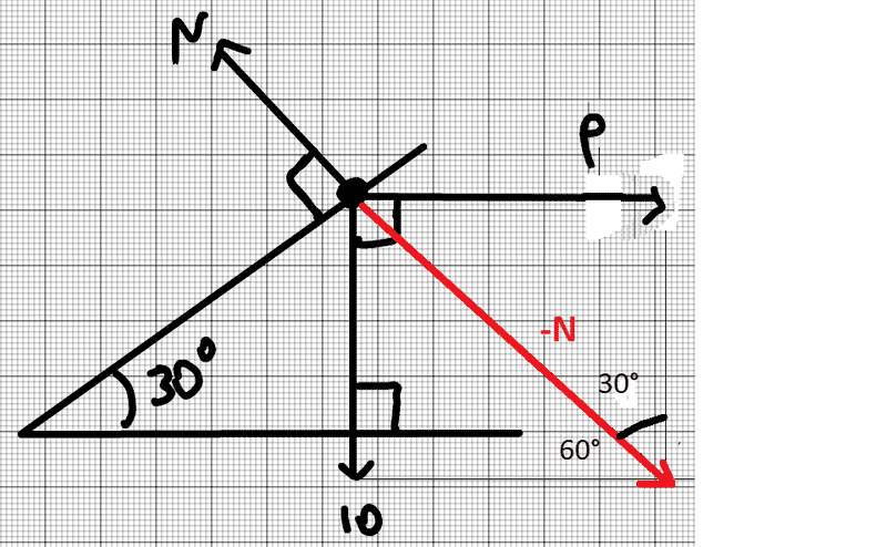

Solve for the forces P and N acting on an object in equilibrium on an inclined plane.
Weight=10N, angle is 30 degrees
http://blob:https%3A//www.physicsforums.com/d431a152-5681-411b-ba57-809320539165
Trigonometry, i.e. sin, cos, tan rules. The 'Z' rule (amongst others) to determine angles.
I have attempted the problem (as done with similar problems, which were correct) however the answers seem to assume that the angle in solving P is 30.
I have used in the Parallel P=10tan60=17.32N. However the answer is given by 10tan30=5.77N. Is the answer wrong? Or have I made inaccurate assumptions?
In the perpendicular, N=10sin60=8.66N, however this is wrong also! The answer is given by 10/sin60
Thankyou for any help.
Assume a frictionless plane.
Resolve N into X and Y directions and it will become clear.

Thank you. I have calculated the correct value of P now but I am still confused as to why N does not equal 10sin60, as P has no vertical component?

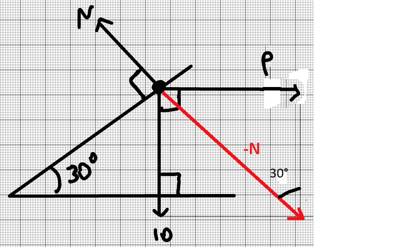

The resultant of the 10 N force and P must be equal and opposite to N.
Now we try to solve using triangular method since net forces equal to zero.
As you you know you can place the vector, the arrow anywhere, parallel and pointing to same direction.
10N is the base, P is opposite, and N is hypothenus.

Thank you very much! It is clear now.
