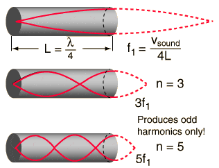

http://facweb.cs.depaul.edu/sgrais/DrumMakerproposal3_drum_shells.htm
L = (c / 4f) - (0.61r)
L represents the length of the shell, c represents the speed of sound within the given medium (wood, metal, etc.), and f represents the frequency of the drumhead's fundamental. Also, this equation takes account of the fact that the reflection of standing sound waves within the shell does not take place precisely at the end, but slightly beyond. Stopped pipes, therefore, act slightly longer than they truly are, so r, representing the radius of the end of the tube, is used in "end correction," a process of making up for this anomaly of "acting" length.
The fact that the stopped pipe resonates when it is only one fourth of the wavelength of the sound which sets it to vibrating is particularly useful in the practice of building drums. A pipe open on both ends would have to be twice as long as a stopped pipe to resonate the same fundamental.
Another useful attribute of the stopped pipe is its natural tendency to strengthen the fundamental. Since a stopped pipe only resonates at odd-numbered partials, one half of all the overtones do not receive any of its benefits, so the fundamental, already somewhat stronger than the rest, is further reinforced.
Therefore, through vibrating sympathetically with a drumhead, each shell strengthens the fundamental both by its own resonance as well as its omission of one half of all overtones in that resonance.
- so this makes sense to me but yet is it accurate enough say a 22 inch in depth bass drum the resonant frequency is 150.3 Hz?
