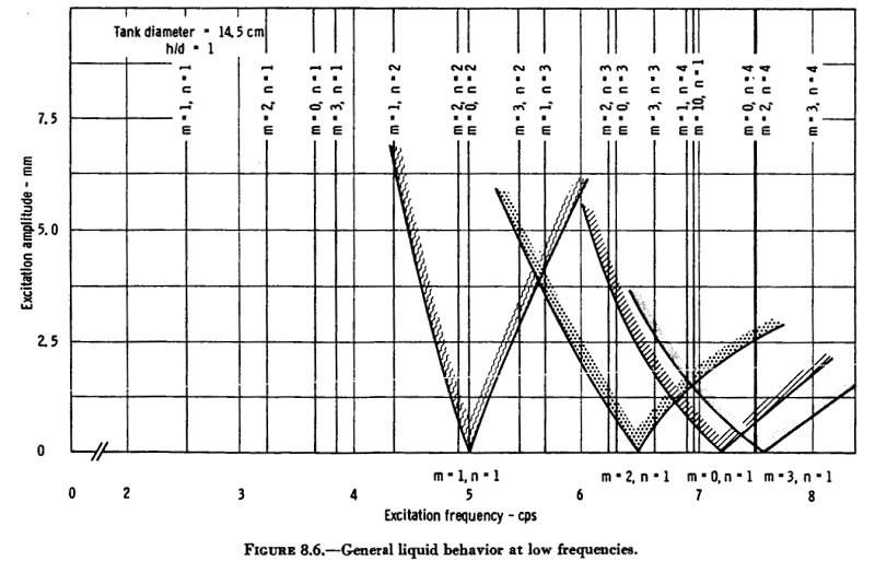

Take a look at NASA SP-106 - The Dynamic Behavior of Liquids in Moving Containers, available as a download at: https://ntrs.nasa.gov/api/citations/19670006555/downloads/19670006555.pdf. Part 1 of Chapter 5 is titled Simulation of Liquid Sloshing.
Chapter 8 is titled Vertical Excitation of Propellant Tanks. Plenty of math, plus some plots of results. Typical plot:
The focus of that document is sloshing in rocket fuel tanks. I found it some years ago when I was working on ways to damp a tuned mass damper.

I appreciate the reference. Chapter 8 looks very similar to what I'm doing, but they examine 90 degree contact angles specifically. But there are references that may be helpful. Thanks for your interest!
