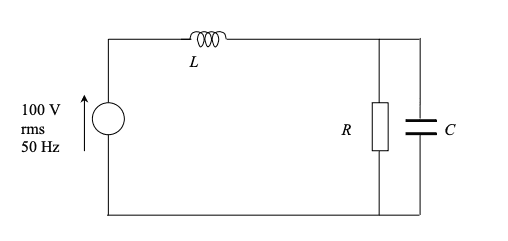

See picture below
XL = jwL
Xc = 1/jwc
I am confused as to why 2 different approaches to finding the resonant frequency of the above circuit contradict; below are the 2 approaches:
Approach 1:
Total Impedance Z = ##j \omega L + (\frac {1} {R} + j \omega C)^{-1}##
At resonance, impedance is purely resistive, i.e. imaginary term = 0.
Imaginary term = ##j \omega L - \frac {j \omega CR^2} {1 + (\omega C R)^2} (= 0)##
Solving, ##\omega = \sqrt {\frac {1} {LC} - \frac {1} {(RC)^2}}##
Approach 2:
Take the Norton across the inductor and voltage source, thereby giving an equivalent circuit with current source equal to ##\frac {v} {j \omega L}## and R, L, C in parallel. This is the standard setup of a parallel RLC circuit with resonant frequency ##\omega = \sqrt {\frac {1} {LC}}##.
Therefore, the 2 resonant frequencies differ slightly. Why is this the case, and which approach is correct?
#1 is correct. I don't think your voltage is correct for #2. The equivalent voltage must be ##v-L\frac{di}{dt}##, but the current i depends on the load, so your expression looks wrong.

I don't think Norton's theorem was applied erroneously. The short circuit current across the voltage source and inductor is indeed v/jwL.

#2 is correct. But this is by definition of resonance. Sorry, I don't have time right now to do the algebra required for a good answer.
It is not true in general that the impedance of the entire network is real at resonance. This is a great question that is often misunderstood, at least according to the way I learned analog EE. Check out my responses in this thread for now.

If ##\omega = \sqrt {\frac {1} {LC}}## is correct it should hold for any value of ##R##. So set ##R=0## in the circuit so that it "shorts-out" the capacitor ##C##. Then the circuit consists only of the voltage source ##V## and the inductor ##L## which doesn't resonate at all. Thus #2 can't be true.

Different topologies have different resonant frequencies. The most realistic circuit model in practical cases places a resistance in series with the inductor, since coils are lossy and capacitors are usually virtually lossless. The L+R series combination can then be either in series or in parallel with a capacitance, producing different resonance frequencies. You can take a look at various topologies here

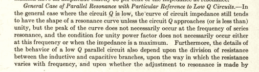

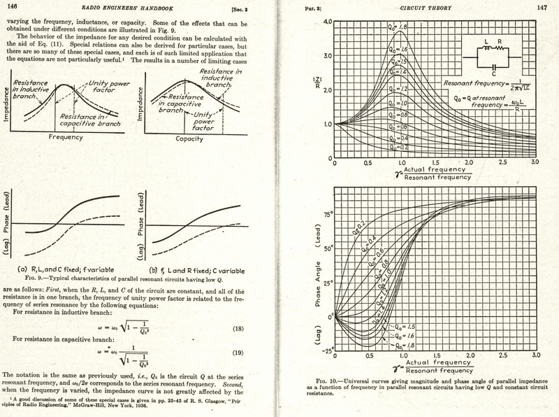

We can refer to the golden bible of radio engineering, Fred Terman's book "Radio Engineer's Handbook." The resonance frequency in the high Q (small R) limit approximates to ##\omega_0=\frac{1}{\sqrt{LC}}##, which is generally true in the high Q limit for all topologies. At low Q, Terman quotes the resonant frequency as
$$\omega=\frac{\omega_0}{\sqrt{1-\frac{1}{Q^2}}}$$
The more common model places a capacitance in parallel with an R+L series combination. This is a better model for practical tank circuits since coils are lossy while capacitors are typically nearly lossless. In this case,
$$\omega=\omega_0\sqrt{1-\frac{1}{Q^2}}$$ where ##Q=\frac{\omega_{0} L}{R}##
I've attached screen shots of the pages that deal with this circuit.

This is a great illustration of the point I started with in the previous thread. There isn't universal agreement about these words.
Terman is defining resonance as the maximum gain (Ok, really something equivalent like maximum or inflection point, etc.). I very much prefer the more consistent mathematically based definition of when the poles/zeros of the transfer function polynomial(s) change from real to complex roots/zeros. This is more generally applicable to complex networks and is not ambiguous. In my experience it is the definition you will find in advanced linear system analysis (control systems, filter design, etc.). I won't dispute that Terman could help you build a radio, but I prefer textbooks to handbooks.
In any case, the underlying point is to be aware of what you really care about and describe it precisely. Memorizing words or blindly following someone else's formula (even if it's golden) will never be as correct as doing the math yourself to get the answer you need. In my experience "resonant frequency" isn't a term you will hear much in grad school except when people are hand waving. In this case the difference between the resonance and the peak gain isn't significant. They will be talking about pole and zero locations in the transfer function, in which case there really is a significant difference between only the real axis and the rest of the complex plane.

Approach #1 is the "lab" version; maximum response is what you will see on your oscilloscope or spectrum analyzer. It is often what the radio designers want.
Approach #2 will require some study of linear systems analysis, and specifically Laplace Transforms. This is an approach that characterizes a system by the mathematical representation in the frequency domain. It may require you to study a bit more to get to these foundational concepts of advanced linear systems. I'm not sure I can explain it online. It's really textbook stuff initially.
