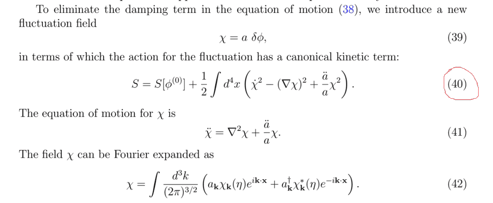

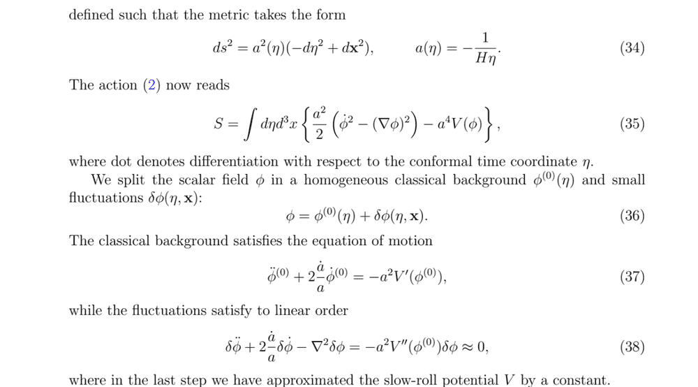

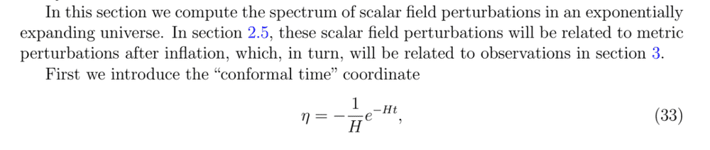

This doubt emerged while studying the lecture notes of my course. I attach the relevant pages
Text describing spectrum of scalar field perturbations in an expanding universe, followed by the conformal time definition eta = -(1/H) e^(-Ht), equation (33).
Typeset page of equations (34) to (38): metric ds^2 = a^2(eta)(-d eta^2 + dx^2) with a(eta) = -1/(H eta), action S with scalar field kinetic and potential terms, background-plus-fluctuation split phi = phi^(0)(eta) + delta phi, and the linearised fluctuation equation.
Typeset page of equations (38) to (42): the fluctuation field chi = a delta phi, its action with canonical kinetic term, the equation of motion for chi, and its Fourier expansion.

in the last line I used that ##-a^2 V'(\phi_0) = \ddot{\phi}_0 + \frac{2\dot{a}}{a} \dot{\phi}_0##. But I'm at a loss about how to proceed :frown:

To advance, you will need to work out the term ##\delta \phi## based on change of variables (39) in the attached pic. If it goes smooth you will find

Try to integrate by parts (IBP¨) the ##2\frac{\dot a \chi \dot \chi}{a}## term. Your action should simplify slightly. Then make use of the E.O.M. (37). Finally you will have to use IBP once again to get the final simplified action :)

\end{align*}Now use equation ##(37)## to re-write ##2a^2 \ddot{\phi}_0 \delta \phi + 4a \dot{a} \dot{\phi}_0 \delta \phi = -2a^4 \delta \phi V'(\phi_0)##, such that\begin{align*}
