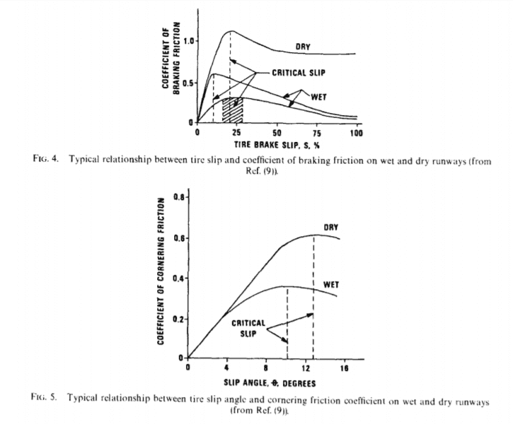

Thanks Cosmik Debris. So I think I am missing something fundamental about tires and cornering at high speed. From the graph above aircraft tires will slow the plane down with greatest deceleration when there is significant slip. From this one can take the inverse problem and it looks like the greatest acceleration for a car or motorcycle in a straight line is when there is also significant slip. From this can I conclude that when cornering at the highest speed possible that both the front and rear tire are slipping to produce the greatest cornering acceleration with the power slid being a technique to increase cornering acceleration? From the graph above it looks like even modest deceleration (or acceleration) whether in a straight line or in a corner causes tire slip?
So, it looks like generally only under conditions of zero acceleration do tires not slip?
Thanks!
Yes I think so.

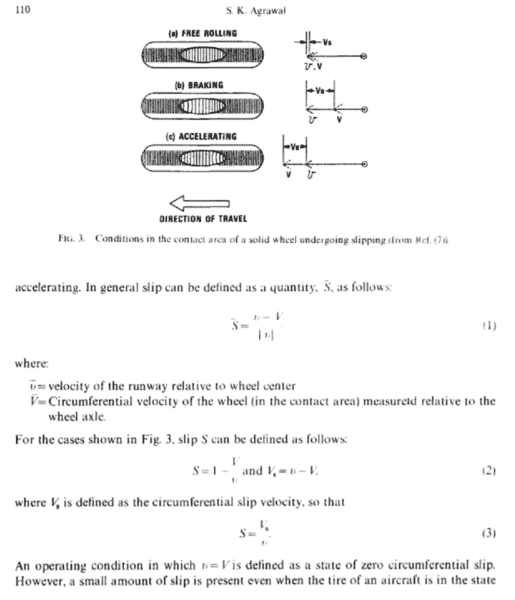

  • Figure 3 from S. K. Agrawal, page 110: three diagrams of a wheel's contact area for free rolling, braking and accelerating, each with arrows for velocities v, V and Vs and a direction-of-travel arrow.
  • Diagram of a solid wheel's contact patch in three conditions, labelled free rolling, braking and accelerating, with velocity arrows V and Vs showing the direction of travel.

  • Two graphs: top, coefficient of braking friction against tire brake slip for dry and wet runways, with critical slip marked; bottom, coefficient of cornering friction against slip angle in degrees for dry and wet runways, with critical slip marked.

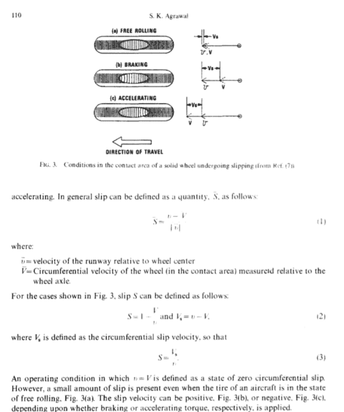

Spinnor said:
I think so if my understanding of some searching is correct. As you know slip has a proper definition as given below,
From the same paper,
Only when there is zero braking or acceleration there is there zero slip?
Thanks!
