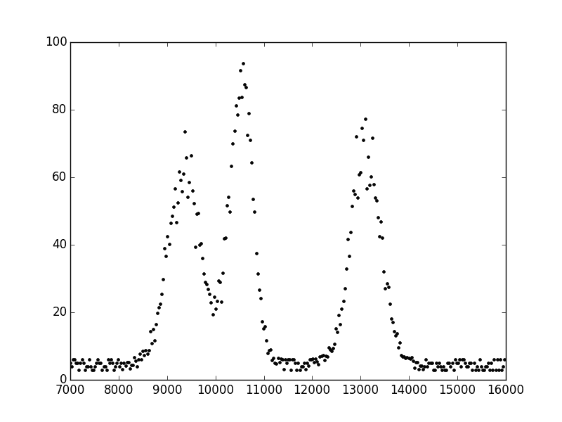

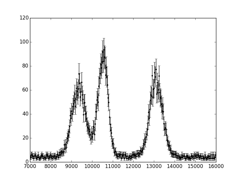

Hello! I have the to fit a curve to the attached data (I plotted it both with and without error bars), where the error bars are Poisson errors i.e. ##\sqrt{N}##, where ##N## is the number of counts in the given bin. I want to fit 3 Gaussians + background and extract the values (and errors associated) of the 3 means and 3 standard deviations. This is the raw data that I was provided with i.e. I was given the number of counts for each value of the x-axis (I don't have the individual values for each element in each bin). What is the best way to fit it? There are many bins with very low count, so I can't assume that the Poisson error is a Gaussian there (<10 data points) so doing a least-square fit might be a bit tedious. Also I am not sure how well it would perform, given that the relative errors are quite big so the relative errors on the parameters of the fit will also be large. I was thinking to re-bin the data. I would reduce the relative error in each bin, but I am not sure what is the right way to do it. Different binnings give slightly different values for the means and standard deviations and I am not sure which one should I pick or how to combine the values from different binnings to give a final value. I guess I can't use max-likelihood here, given that I don't have the individual measurements. What should I do? Thank you!

So the raw data that I have, is the data that I plotted. What I meant is that for a bin with 60 counts in the plot I attached, I don't have the individual 60 entires, I just have the pair, say, (9000, 60).
You are right, rebinning doesn't add new information (actually makes you lose some), my issue is with the error bars (which actually appear, too, in the formula that you mentioned). In Bevington the background has 1 or 2 points with few counts, so assuming Gaussian errors would be ok overall. My plot has lots of points with less than 10 counts. If I do the fit the way it is now, I get a pretty big relative error on the parameters (due to error propagation). If I re-bin, the error goes down, but the value of the parameters themselves changes slightly, too (basically rebinning shits the center of the peak and modify its width). So I am not sure what to do? Should I fit it like this? Should I rebin the data until I have at least 10 counts per bin? Should I do something else?

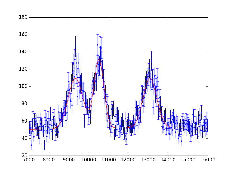

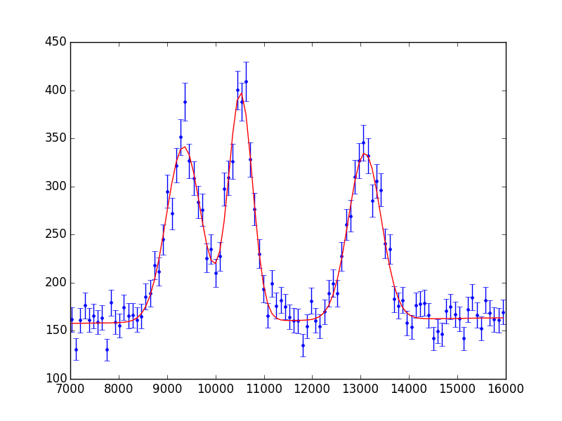

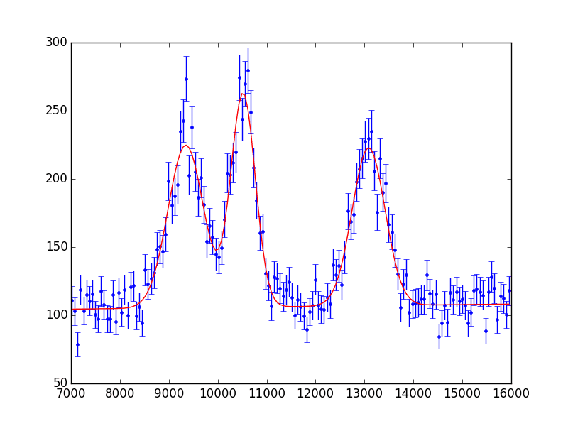

@BvU @gleem Thank you for replies (and sorry for replying so late). So I created some mock data on my own similar to the one I showed in my original post and I fitted the data with 3 Gaussians + background for the same binning as in the original post, half the number of bins (so double bin size) and 1/3 the number of bins (triple bin size). These are the parameters of the simulated data:
mu_1 = 9356
sigma_1 = 340
mu_2 = 10520
sigma_2 = 240
mu_3 = 13103
sigma_3 = 320
and these are the results of the 3 fits (done with the lmfit python package):
Original bin size data:
mu_1 = 9343.368024925216 +/- 23.7795988643757
sigma_1 = 373.37180944261706 +/- 25.054822826597437
mu_2 = 10520.008834943186 +/- 16.296494879212197
sigma_2 = 248.95355107786207 +/- 15.038076584932401
mu_3 = 13079.617291492405 +/- 20.678223331317835
sigma_3 = 342.87157208169833 +/- 19.81801921769196
Double bin size data:
mu_1 = 9347.541487314367 +/- 22.554543873976304
sigma_1 = 364.2159608392336 +/- 23.639726774889134
mu_2 = 10518.672637588254 +/- 16.031782443319145
sigma_2 = 250.11736485722992 +/- 14.91507790224974
mu_3 = 13084.159070450844 +/- 19.897825608583876
sigma_3 = 337.16829832214177 +/- 19.02302371330743
Triple bin size data:
mu_1 = 9344.847309694578 +/- 21.887456335048064
sigma_1 = 358.45903288769614 +/- 22.791553461866997
mu_2 = 10519.310656847158 +/- 15.735789892687324
sigma_2 = 246.67432694916502 +/- 14.611855849087197
mu_3 = 13086.736664298349 +/- 20.198699556016283
sigma_3 = 338.2233185803001 +/- 19.297874643744954
If I were to say, the first one looks the worst (look at the value of sigma_1 for example). So this is why I was tempted to re-bin my data, as the results seem to be better in that case. What do you think? Would you use the number from the original binning? I also attached the fits. Thank you!

We have a different attitude with respect to statistics. If I look at the results I see
Code:
9343    373    10520    249    13080    343
9348    364    10519    250    13084    337
9345    358    10519    247    13087    338
And all three fits give exactly the same result.
What worries me enormously is that you
  1. present these outcomes in 16 digits (would you present them in 64 digits if they were output in 64 ?)
  2. See differences that are the size of 1/3 ##\sigma## and are tempted to consider them different

I don't see that. How big do you think the error on the error is ? Double-size bins make it a little easier for the fit, which works out minimally favourable for the first peak but does nothing for the other two. My conclusion: statistical noise.
Also, you reduce the number of degrees of freedom by double-size or triple-size binning, so the reduced chi squared for the fit should come out higher.
There is no argument for double binning at all: all bins have more than 32 counts, so assumption Poisson = Gauss is OK
And -- if you are forced to do double-binning, you do so only for bins where there are less than 10 counts, not for the other bins.

And the curve is just a fit to those points. What I need is the center of the 3 peaks. If there is a way to get that center (and the errors associated to it) without fitting a curve to the points, that's fine, too. But as far as I know fitting a curve and extracting the parameters is the way it is usually done.
As I've said previously, statistics is subjective. From the point of view of publishing something, it is important follow the traditions used in your field of study and in the particular journal you wish to publish in. So I agree that you should should do things the way other published papers in your field do them. You should also present anything involving "uncertainties" the way other published papers present it. If other papers don't explain how they arrived at their "uncertainties", it's reasonable to email the authors and ask how they did it.
Again my main question is, what is the best way to extract the mean values and the associated errors from the data I showed.
Asking for the best way to do something is a understandable as a human motivation. However , "best" is not a specific property in mathematics - especially in statistics. To ask for the "best" way, suggests that you want to optimize some function, but until that function is defined, "best" is an ambiguous criteria.
I writing "uncertainty" in quotes, because what you mean by that word is unclear. (Likewise "errors" isn't specific.) Since this section covers probability and statistics, a reader is tempted to interpret an "uncertainty" as a standard deviation of a random variable - or some estimate of that standard deviation However, you have not defined any random variable. You don't want to formulate the problem using a specific probability model. I don't blame you for that. Probability models can get complicated. However, if you want to define "the best way" to mean "the way that's most likely to be correct", you are introducing a statement about a probability of something happening. So you can't avoid talking about random variables.

I guess it would be better to put it this way: if someone gave you the data points I showed above, from a single experiment (say a counting experiment, and this is all the available data), and you'd want to publish a paper (say in a common, respectable journal Nature, Science, PRL etc.) in which to present the values of the peaks (e.g. mass of a resonance), how would you do it?
Likes Stephen Tashi
I'm not in academia, but imagining myself in that situation, I'd follow my own advice. I'd look at other published papers and see what they did. If the papers didn't explain their procedures, I'd politely ask some of the authors about how calculations were done.
Having an interest in probability and statistics, it's difficult to resist inventing a method myself - without regard to whether any journal would like it. One idea is to fit a curve (from the family of curves you have specified) that minimizes the ##\chi^2## statistic instead of achieving least square errors. That approach treats the curve fit as a probability model that gives the parameter ##\lambda_i## for a Poisson distribution of counts that (we imagine) is sampled to give the count for the ##i##th frequency bin.
From the curve fit, we get a probability model for how the data is generated and the mean frequency of the 3 peaks. As to estimating the individual ##\lambda_i## and estimating their standard deviations, is it necessary (i.e. is it traditional) to publish such information? For now, I'll just worry about the estimate of center of the 3 peaks and estimating the standard deviation of that estimate.
In the case of estimating a standard deviation for parameters that fit a curve to data, all the methods I know involve a form of reasoning that sounds self contradictory when it is plainly stated. When we use a software that spits out an estimate for the variability of the parameters, we can quote the results without embarassing ourself by explaining how they were derived. The reasoning amounts to this: "Assume the parameters for the curve fit are roughly correct. Then I'll give you an estimate of how much they can be off."
You mentioned doing Monte Carlo studies, so the method should be familiar. Use the fitted curve to define parameters for Poisson distributions at each frequency. Generate sets of pseudo-data from these parameters. Fit a curve to each set of pseudo data and compute the "center" for each curve. Take the set of centers and find the standard deviation of the difference between those centers and the center for the curve fit to the real data. Assume this standard deviation is a good estimate for the standard deviation between the physically "true" center and the center given by a curve fit to real data.
There a commonsense argument in favor of this type of reasoning. If the real data is some sort of freak occurrence, we aren't going to get reliable estimates from it. So we may as well assume it is approximately representative of an underlying probabilitiy model.
I'm not a nuclear physicist. If I were, I wouldn't let myself be lobotomized by statistical procedures. I'd consider whether the above model makes sense in physics. In particular there is the question of how a Poisson process with parameter ##\lambda_i## creates the count in a bin of frequencies. In typical applications ##\lambda_i## is a parameter related to counts per unit time or counts per unit area etc. If we apply the model to a bin of 10 consecutive frequencies we are regarding ##\lambda_i## as parameter related to "counts per unit frequency". Does this make physical sense?
Why change to mock data in #11 ? Or are #1 data mock data too ?
Malamala said:
am not sure what is arrival rate-type data. This is just counts data. For example scanning some energy range and counting the number of certain events.
Your data is what BWV calls arrival rate-type: a count accumulated over a certain time interval. But I expect you know by now.
I strongly agree with @gleem #9 : fit and look at the outcome.
Anxious to see your 11 fitted parameter values (not just 6) and the corresponding chisquared.
And their input values for generating the mock data.
[edit]reason: to me it (#11) does not look like a good fit result
