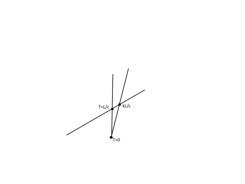

It falls out easily if you use Bondi's 's K-calculus. See https://archive.org/details/RelativityCommonSense
We've got three worldlines on the above diagram. The 45 degree slanted worldline is a lightlike worldline. The vertical wordline and the less slanted worldline are both timelike worldlines. Time runs up the page, space (distance) runs left-right.
By definition the "distance" from the lightlike worldline to a timelike worldline from some particlular event on a timelike worldline (on the diagram, this event is labelled T=0 and is present on both timelike worldlines) is the proper time between elapsed said event and the arrival of the lightbeam.
This may sound technical, but it means if a light beam is headed right for you, and is one light-second away from you, it will arrive in one second, because light travels at the speed of light,.
So in the diagram above, the time of arrival of the light beam for the non-moving observer (vertical worldline on the diagram) is T = L/c, L being the "distance" for the non-moving worldline. The event occurs at T=0, reception of the light signal occurs at T=L/c on the clock carried by the vertical worldline, the proper time elapsed is L/c.
Now, we want to find the distance for the second observer moving with respect to the first. From the diagram we see if if this non-moving observer emits a pulse at the same time he receives the light signal, this re-emitted light signal will be coincident with the lightlike worldline, and by the Bondi formula will arrive at some doppler shifted time kT, k being the doppler shift factor. (If you're familiar with the Bondi k-calculus, this will be obvious, if not - well, I suppose you'd have to read the relevant sections of the book. It's not a bad way to start learning SR. Basically, though, k is the interval of time of transmission to reception, so if we send a signal at some proper time tau from a stationary observer, the moving observer receives it at a time k*tau, k being by definition the doppler shift factor).
But the "distance" to the lightbeam is just the proper time of arrival multipled by c. Since the arrival time is kL/c, the distance to the second observer (the slanted timelike worldline) is kL, k being the "doppler shift factor", in this diagram k is greater than one representing a redshift.
@pervect That was very helpful and easy to follow, thanks.
