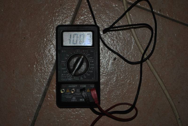

I noticed that I could get a minor belt off my 3 x 1.5KW compressor.
I attached my meter to a mains supply 'socket earth', and to 'the chassis'.
I watched the AC voltage gradually rise... perhaps increasing in speed slightly as the potential difference increased between the chassis and earth... as it approached 100v AC it was rising at a rate of 4v per second.
At 100v AC (on the meter) I switched the motors off, and the voltage dissipated immediately.
I presumed the voltage would keep rising until a failure occurred.
When connected to Neutral (which is connected to a socket earth) - the voltage stabilised at 10v AC.
The amps flowing between chassis and Earth were around 1.4mA.
Clearly, the chassis needs earthing to the Neutral.
However, is a capacitor failing, or is it the motors?
Can anybody explain what is happening?

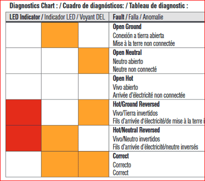

First thing i'd do is check that socket to make sure its Earth connection is indeed earthed by your house wiring,
These work fine, six bucks or so at Walmart
The chassis of your compressor should be tied to the earthing wire in its power cord.
In US that's the green one which is on the longest of the three prongs so when you plug it in Earth makes first to prevent a shock.
I'd say
if your receptacle Earth checks good you have a broken or disconnected Earth conductor in the power cord. And likely some leakage inside a motor. It is not uncommon in US to find the earthing prong cut off a power plug when some unaware individual has used it with a two prong extension cord.
Be careful with that thing, something is wrong. Verify receptacle is earthed, that is important.

ps get the tester with a button for checking GFCI outlets, sometimes pressing the button helps flesh out high resistance connections. It's only about $3 more and worth it.
http://www.kleintools.com/sites/all...nts/instructions/klein/RT200_Instructions.pdf

marcophys said:
Do you have any idea why the chassis is gaining a voltage as described above?
Only guesses at this point. My guess is a capacitive voltage divider between the windings of the motor and your meter.
What kind of meter do you have ?
The little el-cheapo analog meter that i just love for troubleshooting electrical stuff has a 1 ma movement. It measures AC by half wave rectifiying it and displaying average on a scale that converts average to RMS . Works fine so long as you keep in mind what it's really doing.
The average of an AC sine wave is zero and that's what the meter reported initially. Rectifying it with a voltmeter charges the winding capacitance to some DC and that's what my meter would show.
If your meter is not a rectifying type then that idea goes out the window.
Now the 1.4 ma (i assume AC) that you measured is what 125 volts would push through about 0.03 microfarads, 30,000 picofarads which seems high to me.
I hope you'll repeat that measurement after your motor has run long enough to warm up and dry out. Were it mine i'd take off the end bells , blow out the dirt and look for signs of corrosion.. I nave fixed damaged motor windings with a good cleaning and application of varnish.

Tomorrow, i'll upload an image of my multi-meter.
It's a reasonable piece of kit... ohms, hfe, ac, dc, amps, uF, battery.
It's old now... but it's what I have.
Whether it is the rectifying type... I'm not sure.
I'm a mechanical engineer... with a general grasp of electronics... the Earth embarrassment was just that... it just shows that we are all human.
Re the fault... the rising voltage appears as if the chassis is behaving like a capacitor... gradually gaining charge.
The capacitors themselves are big beasts: CBB60 35uF +- 5% class B 450v AC 50/60Hz.
The motors are new... only a few minutes work.
The conditions are dry... and the motors got hot.
To get to 100v on the chassis, was done with the air outputs open.

Here's a pic of my meter:

Let us not forget that I chose to cut the power at 100v AC.
We do not know what would have been the final outcome.
Also, let us not forget, that the 'cause' is still current (chortle :) )
All that we have done is to ameliorate the problem, by feeding the growing voltage leak to earth.
The pic of the 100v is real... and I have another pic at 96.3v taken 4 seconds earlier.
For the free gamblers... the answer on a postcard would be... what would have happened if I had left the motors running?

It seems likely that the problem lies with a capacitor, simply because the chassis is gradually gaining charge... as a capacitor does.
The compressor is on plastic wheels, so there was no way for the charge to run to earth.
The control box is plastic.
This leaves the three metal blow off valves, actuated by N/O relays.
I don't see these being the problem.
The pressure switch contacts are encased in plastic... so no problem there.
That leaves the capacitor studs and the motors.
The key to this mystery is the 4v per second rising potential difference, while the motors are running.
Something must be capable of creating this situation.
The answer may pop into the head two weeks from now.
However, it's unlikely to come from me because in this area of expertise, I don't have sufficient fundamental knowledge floating around my head.
Let's leave it a while, and see if it comes to mind.
At least the compressor is now running safely.
Thanks for all the help so far :)
I = C X ΔV/Δt
were that voltage to Earth DC i'd say
to charge two 33uf capacitors at 4 volts per second requires 66X 10-6 X 4 = 0.26 milliamps
and you measured 1.4 milliamps
but you reported it's AC
so i admit I am puzzled. There's a time to declare victory and leave for the time being.
Mother nature will show us whatever lesson she has in mind when she feels we're ready for it.
old jim
Yes... it was definitely AC.
The photo shows AC was selected.
... we'll solve this problem in due course :)
