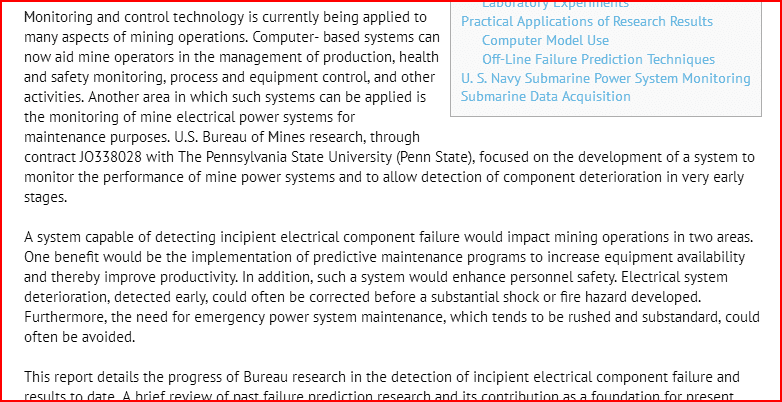

In addition to regularly-scheduled periodic maintenance (PM), and repairing any obviously failed parts, there is also an effort under way in some parts of the industry to be able to try to detect the onset of a failure before it happens. For some electric motor technologies, you can monitor the current and voltage characteristics (especially at startup and under heavy loads), and watch for the early signs of failure. This can be reported to the humans who work with the machines, and they can decide when they want to take the machine down for maintenance.
Here is one reference for such monitoring. The company that I work for has also looked at using this technique to alarm early failure indications in electrically-powered machines and appliances...
https://www.911metallurgist.com/predicting-failure-electric-motors/
