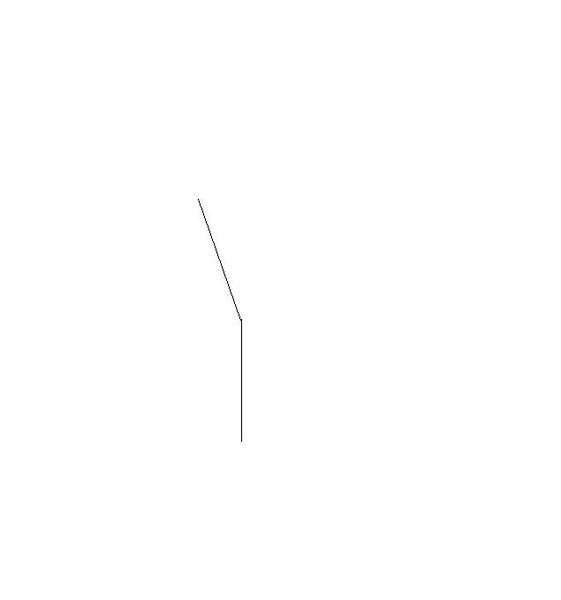

Rear wheels' rigid positioning parallel to the longitudinal axis of the vehicle somehow makes the vehicle (two as well as a four wheeler) go around a curve when steered. If the rear wheel is hinged to the frame making deflection about the vertical axis possible (Like the wheels in TV stands) then the vehicle would deviate from the straight line path only initially and continue along that direction. How does the positioning of rear wheels accomplish this?
Assume that both the front and rear wheel are purely rolling, no lateral sliding. Then the direction of the wheel establishes the direction vector for that point on the system. If the front and rear wheel are not aligned (because either has been steered), then the direction of motion at the front is different from that at the rear. This defines motion on a circular arc, such that these two motions are tangent to that arc. There is a well defined center of curvature and a radius of curvature for this arc. Motion in a straight line is simply the limiting case where the center of curvature moves to infinity and the radius of curvature becomes infinite.
I'm afraid i didn't get the hold of what you said. It would be great if you explain it in terms of forces. In case of a square rear wheel(weird, but just hypothetically) , when the front wheels are steered, the net frictional force act in the direction perpendicular to the plane of the wheel (the one parallel to it go to zero after altering the angular momentum) and as soon as the COM's velocity vector matches the direction of the wheel, forces cease to act (Even though the steering wheel is held at a position different from the neutral position)
But in case of a circular rear wheel, things are different. Forces (centripetal) continue to remain at a constant position of the steering wheel different from the neutral position.
Steering is a purely geometrical effect and does not require any forces at all, provided only massless objects are steered. You complicate it by wanting to think in terms of forces when it is basically a kinematic problem.

Is this a joke? Fit 'massless' square wheels instead of circular ones and see whether your 'massless' honda can be steered.
Why would it be a joke? You are the one who made the foolish proposal to talk about square wheels, not I. I think we are done.
I did not 'propose' to use a square wheel in an actual design. I used it to see what would happen in that case. Is the first law, a foolish proposition to talk about "no forces" acting on a body.??

Like was mentioned in other posts, the intersection between the axes of the wheels establishes the turning radius. If you angle the rear wheels in addition to the front wheels, you can move that intersection closer to the car and reduce the turning radius.
Why should the turn center lie on the intersection? I have read this in several books and in this thread especially. But why?
I know you intended to make things more clear, next time maybe you could draw a diagram with the axis labelled or something. It's nothing you've said or described badly, its just text descriptions are sometimes inadequate, especially to idiots like me who don't tend to read them thoroughly enough.
I've reread it now and doodled a few diagrams of each situation. I'll deal with this last post first.
This is purely a geometry thing. To turn and follow a circular path you much be turning about a central point. The point of a circle can be found by drawing two lines normal to the curvature of the circle, where they meet is the centre.

What i think about this is that the frictional forces perpendicular to the planes of the front and rear wheels exert a torque about the COM such that the longitudinal axis of the vehicle always remain tangential to the curve the vehicle traces.
This is sort of the right thinking. Its not friction force however, the force you attribute to friction is the 'side force'.
The side force comes from the slip angle (sorry, i can't help it =, this is where the force comes from :P), the forllowing description isn't slip angle but will suffice for what we want to discuss.
All this basically is, is the direction the car wants to travel in (stright forward) and the direction the type is pointing in. There is an angle between the two. The line that connects these two is the side force.
As you say this force acts perpendicular to the wheel travel and creates a moment (not torque) around centre of the car. Causing yaw. So long as th is yaw rate is the same as the curvature you move tangential to the circle path.
