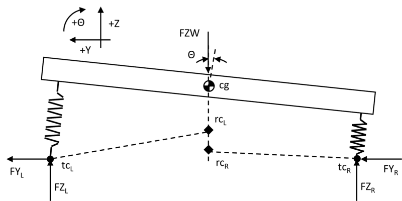

I have run into a problem when trying to model a simplified vehicle that has three degrees of freedom – roll, vertical and lateral motions. It is represented by a single mass with two links that model the suspension behaviour. The links connect the tyre-to-ground contact points (tc) to the body at the ‘roll centres’ (rc). The motion of the points tc and rc are described by known polynomial curves that are a function of the body position relative to ground, so the link lengths and angles to ground vary according to the motion of the body. However, rc is always directly below cg.
The suspension between the body and the tc points consists of three elements that are described by the body position and velocity relative to ground. Forces are also transmitted to the body through the two links and being massless these are calculated using static force and moment balance equations.
The input to the model is a lateral force (FY) but this force is shared between the two tc points in proportion to the vertical forces at these points. I have set up the differential equations for the body in the usual way and have written the equations for the motion of the links. The problem I have is how to formulate the link force and moment equations so that they are solved using a Matlab ODE at the same time as the body motion.

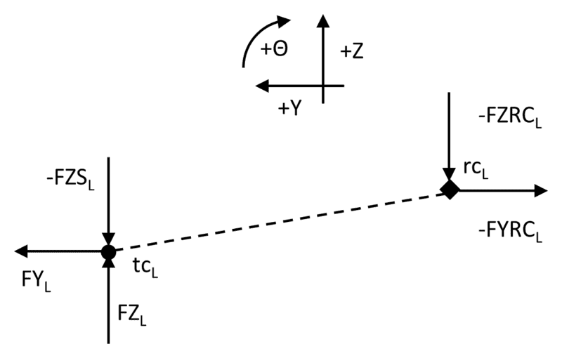

The free body diagram for the left link is below, as an example. The suspension force FZSL is described in terms of the body motion, so I think this should be solvable. The points rc and tc are also described by the body motion and, consequently, FZRCL and FYRCL are scaled in proportion to the angle between the link and the ground (that is to say, their resultant is parallel to the link but their magnitudes are unknown). So, the remaining four forces need to be solved, but these are directly a function of FYL, which is a function of FZL, through the statics equations.
The problem I seem to have is finding a way of arranging the static equations for each link so that they are written in terms of the body motion. However, each attempt I make to rearrange them fails to do this. I perhaps have too many unknowns and not enough solvable equations.
The body equations are:
maY=FYRCL+FYRCR
maZ=FZSL+FZSR+FZRCL+FZRCR–FZW
IXθ¨X=FZSL⋅tcyL−FZSR⋅tcyR+FYRCL⋅(cgz−rczL)+FYRCR⋅(cgz−rczR)
The equations for the left link are (taking moments about rc):
FYL+FYRCL=0
FZL+FZSL+FZRCL=0
FYL⋅rczL+FZSL⋅tcyL+FZL⋅tcyL=0
The equations for the right link are similar.
The input to the system is FY, and:
FYL=FY⋅(FZL/(FZL+FZR))
FYR=FY−FZL
Sorry for the longwinded post but I’d be very grateful for any direction you could give.
Thanks.

There isn't anything more I can say to describe the model and its parts, so I'll re-write my previous replies in a list of salient facts to see if that brings clarity:
1. The model is a planer front view of a single axle vehicle comprising a body with a suspension system on each side
2. Each suspension system is represented by an instantaneous link that runs from the tyre contact point (tc) to an instantaneous centre (not shown, and not required)
3. Each instantaneous link is described by a known polynomial which defines the lateral position of tc relative to the body as a function of the body to ground vertical displacement (in a body axis system)
4. The same polynomial can be used to define the angle between the instantaneous link and ground
5. Whilst a set of equations describing the forces and moments at the connections between the instantaneous centres and the body could easily be written, it is common practice to transfer the forces to the points where the instantaneous links intersect with a vertical line down from the CG. This is done so that the vertical components of the forces in the links serve only to raise or lower the body without causing any moments on it, whilst the lateral components act to accelerate the vehicle sideways and to generate a roll moment
6. The roll moment is reacted by the springs, anti-roll bars and dampers
7. For information: it doesn't matter where along the links the forces mentioned in point 5 are transferred to, so long as their components act on the body with the appropriate moment arms. The vertical and lateral forces and the total roll moment are the same in each case.
I think that's everything so I hope that helps.
$$FY_L+ FYRC_L=0$$
$$FZ_L+FZS_L+FZRC_L=0$$
$$FY_L*rcz_L+FZS_L*tcy_L+FZ_L*tcy_L=0$$
The equations for the right link are (taking moments about rc):
$$FY_R+FYRC_R=0$$
$$FZ_R+FZS_R+FZRC_R=0$$
$$FY_R*rcz_R+FZS_R*tcy_R+FZ_R*tcy_R=0$$

Please note that ##tcy_L## has been corrected to ##tcy0_L##. This was a change in my code that I had forgotten to update in my documentation. Apologies.
The first equation is the spring rate multiplied by the suspension displacement plus the static spring force. The static spring force is in the global Z direction because the spring is vertical when the model is at rest. The second equation is the suspension displacement and is derived from a parameter called ground-to-body displacement, which is always a vertical displacement. The suspension is always parallel to the body so the cosine of the roll angle is used to convert the ground-to-body displacement to suspension displacement. The third equation is the ground-to-body displacement and is derived as follows: Imagine the model at rest and with rigid suspension. Then consider the body of the model at the next position with the links positioned according to the fact that the suspension is rigid. The vertical difference between the tyre contact points and their original positions (i.e. on the ground) is the ground-to-body displacement. This definition is used by our suspension parameter measuring machines at work but I'll skip the reasons why. The point is that the polynomial that defines the way the tyre contact points move relative to the body is a function of this ground-to-body displacement and is data that I can obtain that describes the behaviour of real suspension systems. Thus, I need to use the same definition as the machines to make the polynomial useful to me. The equation is simply a rotation about the body CG by the body roll angle plus a translation to the new body CG position. This equation is only the vertical component of that sequence. So, I would say that the unknowns here are body positions Y, Z and Θ.
I take your point about the suspension velocity but I have always aimed to avoid using a gradient function, or similar, if I can specify the correct equation directly. I will check back through my notes to see how I arrived at the equation I've used. Excepting that, the damper force equations follow the pattern of the spring force equations. The anti-roll bar force is the roll stiffness multiplied by the difference between the suspension displacements.
The suspension forces are summed and then the vertical component taken using the body roll angle to get a vertical force at the tyre contact point.
The equations for the angles of the links to ground and the positions of the roll centres are only a function of the body position, via the polynomial and the ground-to-body displacement.
Going back to the FBD of the links: the suspension forces (##FZS_L## and ##FZS_R##) are described above. The remaining forces are unknown. If ##FY_L## and ##FY_R## were known then there would be no problem. However, as they are in proportion to the respective vertical forces (##FZ_L## and ##FZ_R##) at each point, they remain unknown.
I am uncertain whether I have written all that is needed to explain the problem so please let me know if more information is required.
