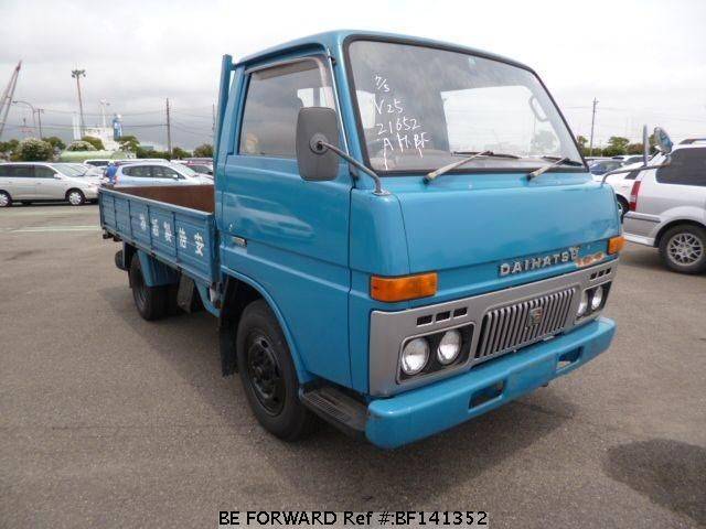

the device that I have is the same as the mirror of this truck.

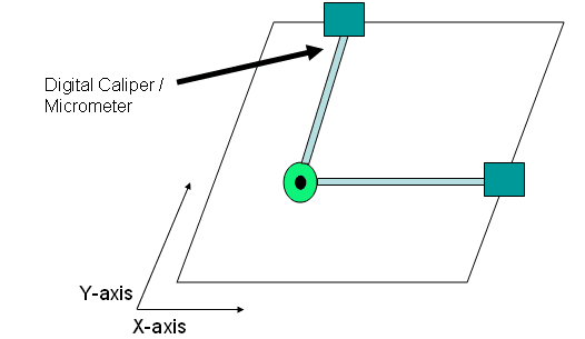

The best I can do is show a simple 2-D example with 2 rods attached to an object that can move in a plane. The rods are fixed to the object (with swivel joints) and pass through micrometers (that can swivel) located along 2 orthogonal edges of the plane.
https://electronics.stackexchange.c...osition-of-an-object-constrained-to-x-y-plane

For 2 degrees of freedom, perhaps the simplest and least expensive is hinted at by the example you gave, the truck mirror!
Glue or otherwise attach a small mirror then shine a Laser beam on it. The movement of the reflection to a wall or screen at a measured distance gives enough information to find the angles.

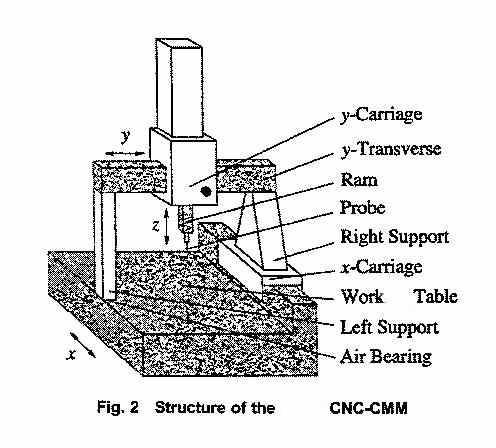

being involved in dimensional measurement since1980, i have seen this before. You are asking for what the manufacturers of coordinate measurement machines (CMM) have sought since 1959. Instead of a gas pedal pivot ball orientation, the makers of the CMM seek the XY and Z location of a ball stylus in the cartisean coordinate system. This is done with mechanical structures that move in xyz axis and have digital scales and read heads.
All measurement is calculated from the center point of this ball stylus probe.
Other times they use photo optic grids located in an xyz location and use a laser projector(emitter) fixed , in your case, to the pedal and monitor the laser beam location on the xyz location. In some cases they may attach a second laser emmiter to the pedal at 90 degrees and even a 3rd laser emitter at another 90 degrees to " map" the xyz movement.
look up CMM

Thanks Mike,
The pedal will be attached to a small animal foot ,so I am afraid that this huge device will hinder the foot rotation.
Is there small CMM devices that can fit my application?

https://tech.faro.com/faroarm/?C_Le...MrL6oYC8gJhdLyKhz25eoxgp9sCGVHThoC9OQQAvD_BwE
what this is for you new people is a manual CMM arm. The CMM is operated by a human being ( not cnc controlled) so you have a manual CMM. The cmm operator places the ball stylus on the part to be measured. He pushes a button when the ball is resting on the intended feature and a data point is recorded. The arm is constructed with 3 rotary encoders so the XYZ location in space is known ( once calibrated).
What you are doing is wanting to track the ball stylus center point realative to the xyz axis. Instead of the cmm operator moving the ball stylus probe to touch the part, you are anchoring the cmm arm and permitting the probe to articulate via the gas pedal. May take some fixturing but the basics are here.

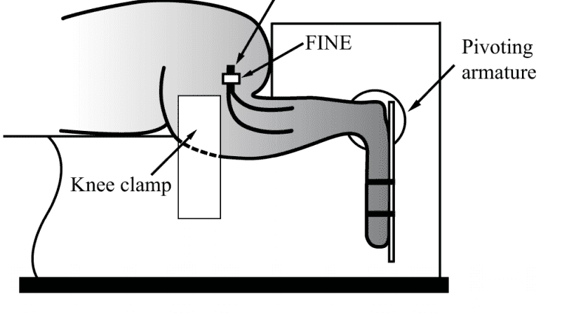

the animal will be sedated and its will be strapped to the pedal as in following picture.
So, instead of the pivoting armature, the pedal will have a ball and socket joint with little resistance to rotation.
Thank you for posting that picture.

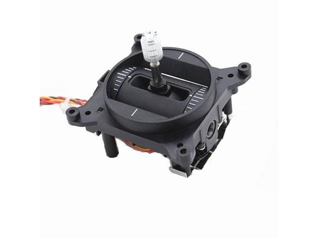

If I understand correctly, the measuring device should have its axis of rotation more or less acurately aligned with the joint of the cat's foot.
Perhaps something light and soft as a gimbal and two potenciometers, just like used in radio control transmitters, or even and old style ball computer mouse, could be connected to a computer for registering continuos 2-D movement.
Please, see:
https://www.thefscreations.info/2019/12/making-professional-rc-transmitter-with.html

I hope I can find such device, I can not build one my self.
can you provide me with the name of the device in the picture.

Use joystick potentiometer (try https://www.digikey.com/en/products/detail/adafruit-industries-llc/3102/6152821?utm_adgroup=Navigation%20Switches%2C%20Joystick&utm_source=google&utm_medium=cpc&utm_campaign=Shopping_Switches_NEW&utm_term=&utm_content=Navigation%20Switches%2C%20Joystick&gclid=CjwKCAiArbv_BRA8EiwAYGs23CgXVUYH7JC0ganxecYkCdGHS8jOXWCOepLtHJGwoqoq-3xNF4VRNhoCR4AQAvD_BwE) and read it using A to D dongle
