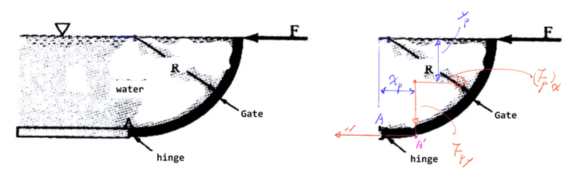

Please help me to understand why it is wrong to take moment for point ## A’ ## , because I think static equilibrium should be static equilibrium for any point in space.
Method 1:
$$ \sum{M_A=0:} $$
$$ F\cdot R=\left( F_p \right) _x\cdot \left( R-y_p \right) +\left( F_p \right) _y\left( x_p \right) $$
$$ F=\frac{1}{R}\left[ \left( F_p \right) _x\cdot \left( R-y_p \right) +\left( F_p \right) _y\left( x_p \right) \right] ..........\text{(}Ans\text{)} $$
Method 2:
$$ \sum{M_A’=0:} $$
$$ F\cdot R=\left( F_p \right) _x\cdot \left( R-y_p \right) $$
$$ F=\frac{1}{R}\left[ \left( F_p \right) _x\cdot \left( R-y_p \right) \right] ...........\left( wrong\ answer \right) $$

Never mind, I think you are saying that ##F_p## is the resultant force acting on the gate. How did you figure out where the ##x## coordinate of ##A'## is?
Also, and maybe this is the problem but there has to be a vertical reaction force acting on the gate? If ##F_p## is the resultant, from what I'm seeing you have shown no vertical reaction force that could possibly balance the vertical component of ##F_p##?

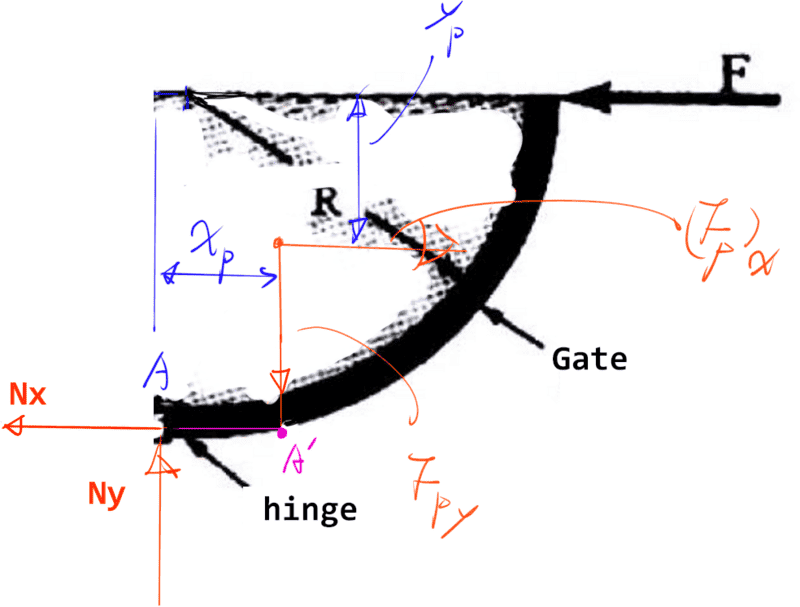

see https://upload.cc/i1/2022/12/21/QHOYL5.jpg
Yeah, I get that.
Where is the vertical reaction force at ##A## that is necessary to balance the vertical component of ##F_p##? You have to satisfy two relationships.
##\sum F = 0 ##
##\sum M = 0 ##
Likes tracker890 Source h

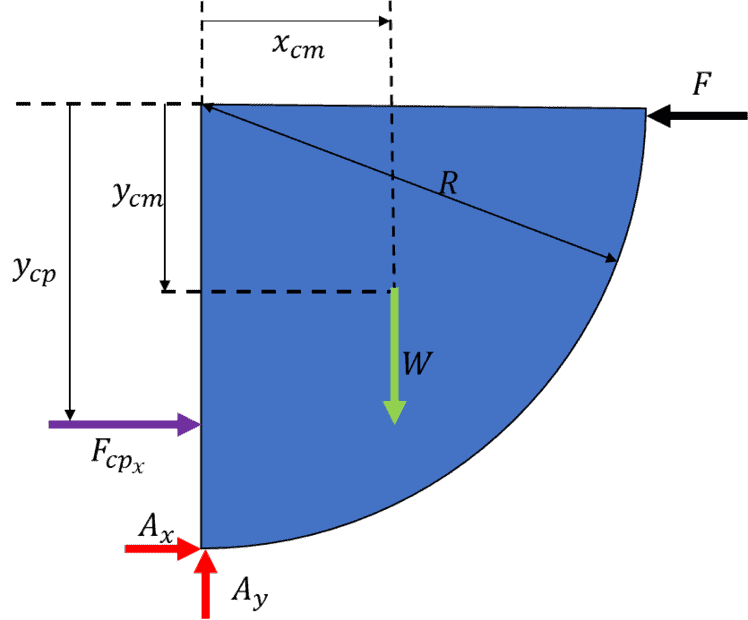

I think the free body diagram should be changed as follows:
Therefore, it is more convenient to take the moment at point A.
Likes Steve4Physics and tracker890 Source h
Just to add to what @erobz has said…
The reaction force of the hinge on the door (a point A) has an unknown magnitude and direction. This reaction force produces a moment about point A'. This moment hasn’t been included in (Post #1) Method 2
(When taking moments about point A, as in (Post #1) Method 1, the reaction can be ignored as it passes through point A.)

You know that the reaction forces at hinge A are:
Fax=F+Fpx
Fay=Fpy
Note that yp will be the location of the centroid of a triangle formed by the horizontal pressure distribution, while xp will be the location of the centroid of a quarter of circle formed by the vertical pressure distribution.
Likes tracker890 Source h and erobz
