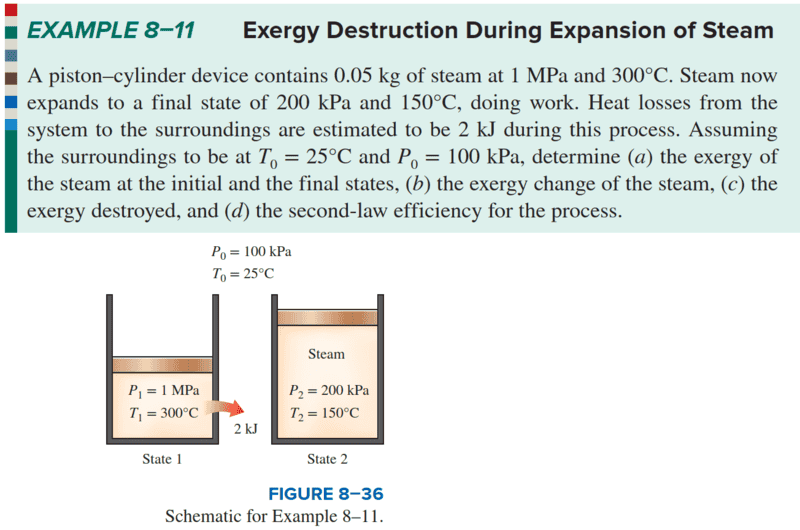

Using different methods to solve for the 'maximum reversible work,' the self-solution and the answer differ, and it is unclear where the error lies.

Q: The maximum reversible work, self-solved, is as follows: Only when equation (5) equals zero will it match the textbook solution; kindly indicate any errors in the self-solution.
reference. : sol.; exergy balance; CMS.; wrev.
Q:
Only when equation (5) equals zero will it match the answer; please kindly point out any errors.

Please describe the process you envision to go from the initial state to the final state of the system.

This is not the process that the system experienced. It is the equations you used. What’s the detailed process that these equations correspond to?

Imagine a system in a quasi-static state, with a thermodynamic process occurring from state 1 to state 2.
How do you know that this was the proces that brought about the change?

I'm sorry, I just don't follow what you are trying to do. I'm guessing, you have been trying to devise a reversible process between the initial state and final state of the system, and comparing the work done by the system in that process (over and above work to push back the surroundings) with the decrease in exergy of the system. Is that correct?

What you said is correct.

OK. And what is the mismatch algebraically?

Why is equation (5) not zero?

Did all the heat in your reversible process on the system get transferred to the surroundings reversibly at T0? That reference you cited makes sense to me. You need to maintain the same original system and surroundings.
If I were going to analyze a reversible process for the system to go from the initial state to the final state under the constraint of constant total volume of system and surroundings, and no heat transfer from this combined microsystem, I would do the following:
1. Adiabatic reversible expansion of the steam to the final volume
2. At constant volume of system, reversibly transferring heat through a Carnot engine setup with the gas as the high temperature reservoir (with temperature decreasing) and the surroundings at T0 as the low temperature reservoir.
The combined system work from both these steps (for the combined macros system of system plus surroundings) should equal the decrease in exergy of the system between the initial and final state.

To avoid confusion, I'll use the precise term "available energy" from the textbook.
  1. The method you described is the approach by the author Yunus A. Çengel: assuming the process is entirely reversible to determine the available energy.
  2. Another approach is from the authors CLAUS BORGNAKKE and RICHARD E. SONNTAG: preserving the original irreversible thermodynamic process, subtracting the irreversible part, to obtain the method for a reversible process, and then determining the available energy.

To do this, don't you need to know the amount of entropy generation?

I don’t think so. As long as you use a reversible process, the exergy decrease will be equal to the maximum work you can derive from the combination of system and surroundings.
