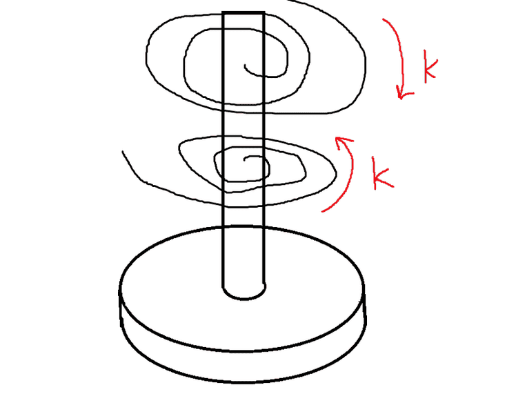

I would like to calculate the function of a rotating disc that has 2 spring slowing it down. (look at my pictures to understand)
Let say I turn my disc 90 degrees clockwise and release it, it is going to oscillate a certain moment than stop.
I want to plot that function and to have a sinus function decreasing to 0 after a "x" number of period.
Thanks for your help,
Jean-Philippe
Doesn't work quite like that. A torsion spring pendulum is typically described by damped harmonic oscillator equation. For the equation of the following form.
[tex]\frac{d^2x}{dt^2} + 2 \zeta \omega_0 \frac{dx}{dt} + \omega_0^2 = 0[/tex]
And for initial conditions [itex]x(t) = x_0[/itex], [itex]x'(0) = 0[/itex], the general solution has the following form.
[tex]x(t) = x_0 e^{-\zeta \omega_0 t} \left( cos(\omega t) + \frac{\zeta \omega_0}{\omega} sin(\omega t) \right)[/tex]
Where the angular frequency is [itex]\omega = \omega_0 \sqrt{1-\zeta^2}[/itex]. To figure out the parameters [itex]\omega_0[/itex] and [itex]\zeta[/itex], you can follow prescription in the torsional harmonic oscillators article. But basically, you want [itex]0 < \zeta < 1[/itex] if you want decaying sinusoidal motion. Higher value will result in faster decay, but there is no way to say that it will make N oscillations. Each oscillation will be smaller than the last by a fixed ratio, but it never goes perfectly to zero. And, of course, once you figured out [itex]\zeta[/itex], you can find [itex]\omega_0[/itex] that gives you desired frequency of oscillations.
This is my project, it is not a pendulum.
