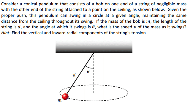

ƩF = ma
I know how to break this problem up into the x and y direction
Y Direction:
Ft cosθ - Fg = 0
X Direction:
Ft sinθ - Fg = mv2 / r
The hint says to find the inward radial component. I'm guessing this means to find r, because I think that is the only thing missing for me to solve this. To find r I think I would use some combination of the length of the string and theta, but don't exactly know.
Thanks for any help!
The "inward radial component of the string's tension" is just the horizontal component of the the tension force (i.e., what you called the X component of Ft).
You've got -Fg acting in both the Y-direction and X-direction?
You should be able to express r in terms of d and theta using trig on an appropriate right triangle.
You'll have two unknowns, Ft and v. But you'll also have two equations. Try eliminating Ft and solving for v.
When it was talking about the vertical and inward radial components, it was talking about finding Fty and Ftx, which is what you have already done. You know r because you know d and θ. Just solve the two equations for v, and you're all set.
There is no -Fg in the x direction, silly me.
r = Ft sinθ?
Y Direction:
Ft cosθ - Fg = 0
Ft = Fg / cosθ ??
X Direction:
Ft sinθ = mv2 / r
(Fg / cosθ)sinθ = mv2 / (Fg / cosθ)sinθ
? lol I am so confused

Get an expression for r in terms of d and theta, not in terms of Ft and theta. Consider the right triangle where the string is the hypotenuse and the radius r is the side opposite theta.

Ohhh. r = dsinθ. Whick makes...
((mg / cosθ)sinθdsinθ) / m = v2
Then I would just take the square root of both sides.
