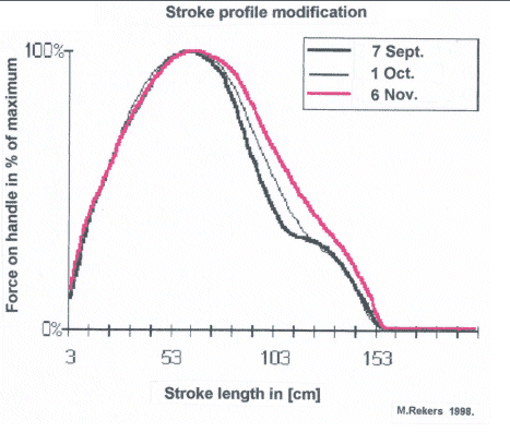

Efficient rowing depends more on the time profile of forces during the stroke than it does on angles. One example is shown in the picture (I prefer to plot it with time on the horizontal axis). Through the stroke, shoulders, arms, back, and leg muscles all contribute at different times within the stroke.

Thank you for your helpful reply, anorlunda. If I may, a few questions:
Your graph has stroke length versus force; where does time come into it?

But if I understand your graph correctly (which I probably don't), it seems that there is an optimal length, around 60 cm.

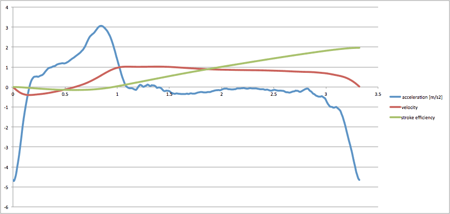

I interpreted stroke length in the first plot as the distance moved relative to the beginning of the stroke. Thus it changes with time. Here's a better time-based explanation.
https://www.rowinginmotion.com/stroke-efficiency-explained/
In this figure, the horizontal axis is time. You have to read the linked article for a full explanation.
246573
