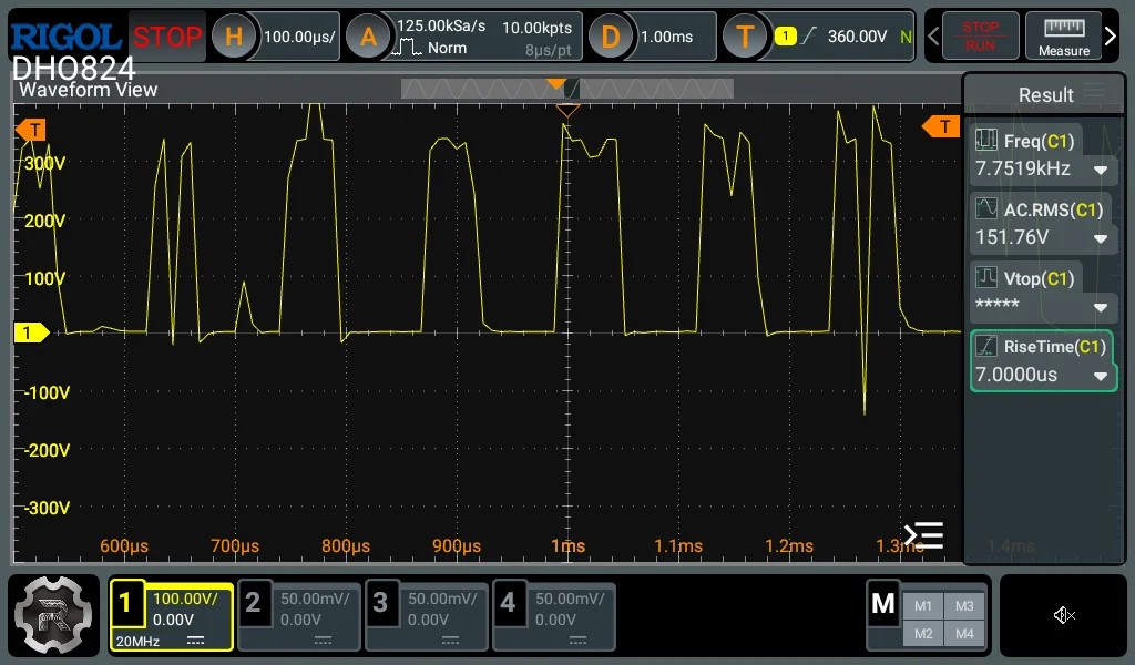

The mill motor in delta.
I borrowed a HV differential probe, but it’s telling the same story, ie that the filter is somehow making the waveform messier.
1. No filter, output overview:
2. Pulses (occurring at 8 kHz) have a rise time of 6.56 us:
3. + filter, output overview:
4. Pulses had an irregular appearance:

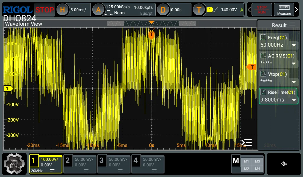

5. A better one. Slower rise time, but a lot more ‘features’:
From research, it seems that only very long VFD-motor cables need a proper sine filter. For short cables, as here, a simple output reactor would suffice, but these cost more than a replacement motor, which being a modern type would not need the reactor.

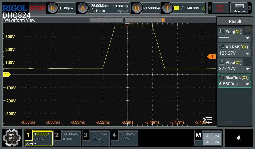

I need to see the data points to know if it shows the zoomed in sampling rate, or the real rise time.

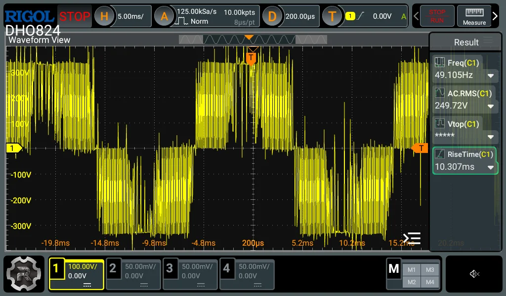

I can see the motor drive sinewave in that plot.
What is the cutoff frequency of the low-pass filter.
What is the frequency of the PWM output.

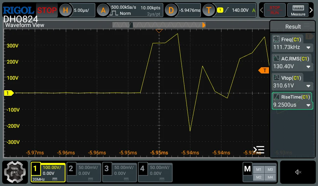

It looks like you zoomed too far into a waveform, until we see the data acquisition rate. That does not show the slope dv/dt, of the motor drive waveform, which should have been reduced by the LPF.
What is the Y filter centre connected to, or is it floating?
As before, I can’t get triggering when zoomed in (or out). Is it better to zoom in, and keep taking single shots until a decent picture appears, or zoom out and force full memory depth of 50Mpts?
8 kHz

Configured as per post #35, the caps are in delta and had to be replaced with 2.2 nF, as the 0.47 uF ones were tripping the VFD. Do you mean the LPF in the VFD? I haven’t been able to find that out.
The VFD was expecting to drive an inductive motor. You raised the frequency of the LPF by 470 / 2.2 = 200 times. That explains why the dv/dt is higher than I expected. There is little point using that filter in that situation. You would need to increase the inductance to compensate.
Looking at this another way, this link: https://vfds.com/blog/how-do-you-size-a-line-reactor/ suggests the standard for VFD load reactors is 3% of the motor’s impedance.
This motor was originally plated for 400/440 V, 50 Hz, 1.8 A. Taking 415V as a common figure in that range, when I extracted the star point to convert it to delta this changed to 240 V, 50 Hz, 3.1 A.
Would this represent a motor impedance per phase of 240/3.1 =77.4 ##\Omega##?
3% of this would be 2.3 ##\Omega##.
At 50 Hz, this would be 2.3/##\omega## = 7.4 mH. The only trouble being, the mill is used between 10-100 Hz depending on the operation. However, it’s set up so that 50 Hz is the most commonly used speed.
