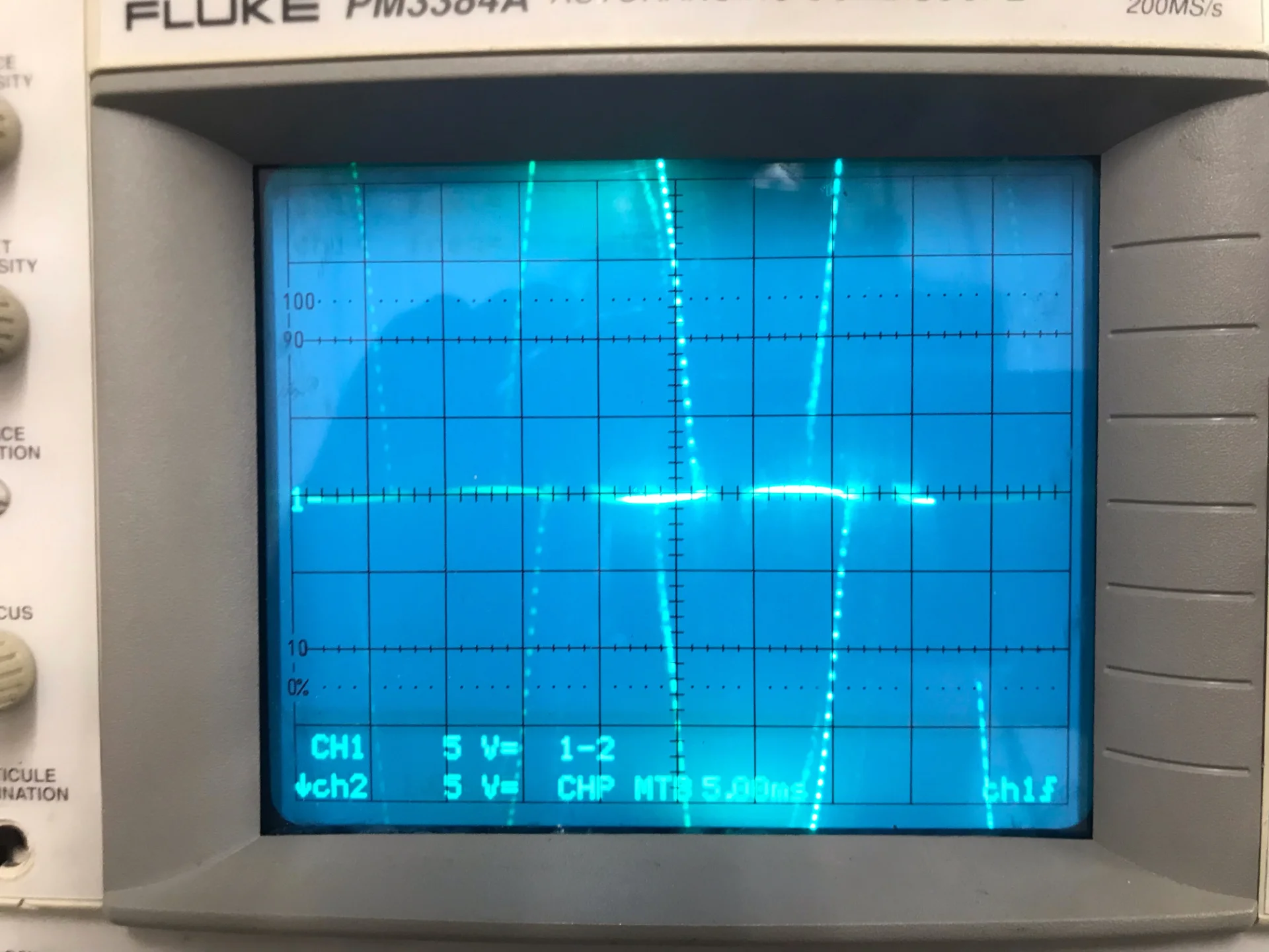

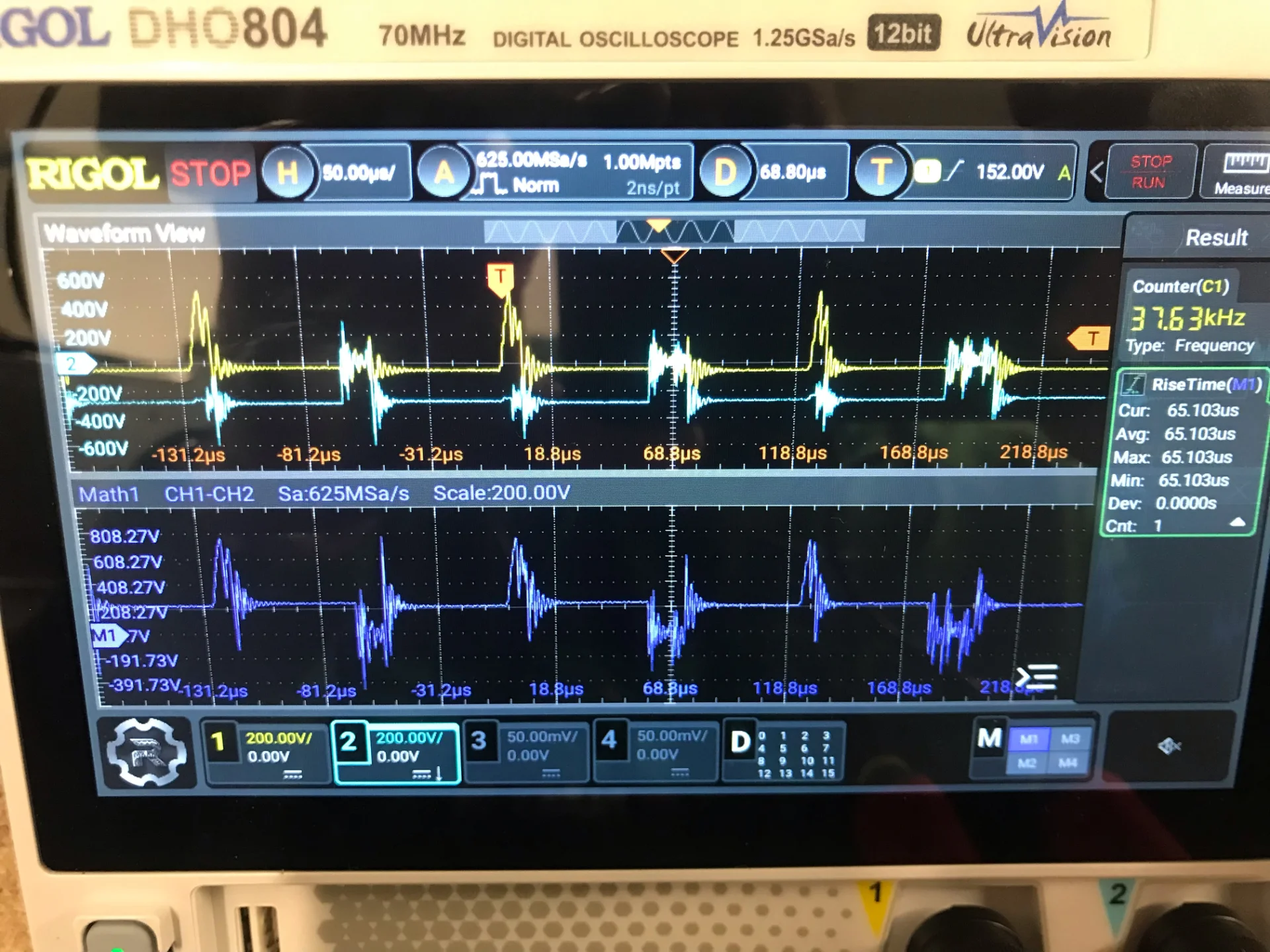

Try as I might, I couldn’t get the scope to trigger properly. This is channels 1 and 2 on U and V terminals of the motor, scope set to CH1-CH2, 10x probe setting. The changing image was hard to get on camera:

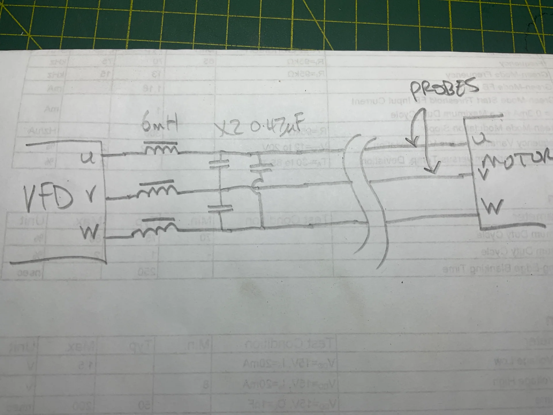

Next the filter circuit was added:
However, the VFD threw an overcurrent error on start-up until I removed the capacitors, and replaced them with Vishay VY1, 2.2 nF, X1/Y1 rated ones. The VFD manual does mention that very long motor cables can have enough distributed capacitance to trip the protection, so maybe this is related.
Again, I had triggering problems with the subsequent scope shot, but it still looked ‘steppy’ like the first one, with or without the alternative Vishay capacitors. Might the chokes be saturating?
I think I need to sort the triggering before I can do any more meaningful experiments. Would a modern digital scope cope any better?
I think the two channel amplifiers are saturating before the subtraction is done.
You need more attenuation.
Do you have a neutral available on the 3PH output?
No neutral. The VFD output is 240 V P-P. How come it displayed the real 240 V mains ok?

240VRMS is 340 Vpk = 680 Vpp centred on zero.
240 volts RMS, makes 415 VRMS per line pair, or phase winding, with peak phase voltages over 580 volts, about the neutral or zero volts, giving 1160 volts peak-peak vertical.
The oscilloscope has 5 volts per cm, x10 probe, and 8 cm, giving a 400 volt vertical range. That cannot display 1160 volts PP.
You will need to make a compensated attenuator adapter to go between the 3PH supply and the oscilloscope.
But the VFD isn’t a step-up type - the output is three-wire, effectively delta, 3ph at 240 Vrms phase and line voltage. It should, as I understand it, take the form of 340 Vpk (680 Vpk-pk) pulses of varying width. Could it be that the very thing we’re trying to get rid of, voltage overshoot and ringing, is preventing the scope from triggering? This article shows some scope shots that suggest it might be:

It's pretty clear to me that you don't have the input attenuation set up correctly on the scope. As far as triggering goes, if you're worried about correct triggering set the scope to trigger off of the power line and set the VFD to output the same frequency as whatever the power line frequency is.

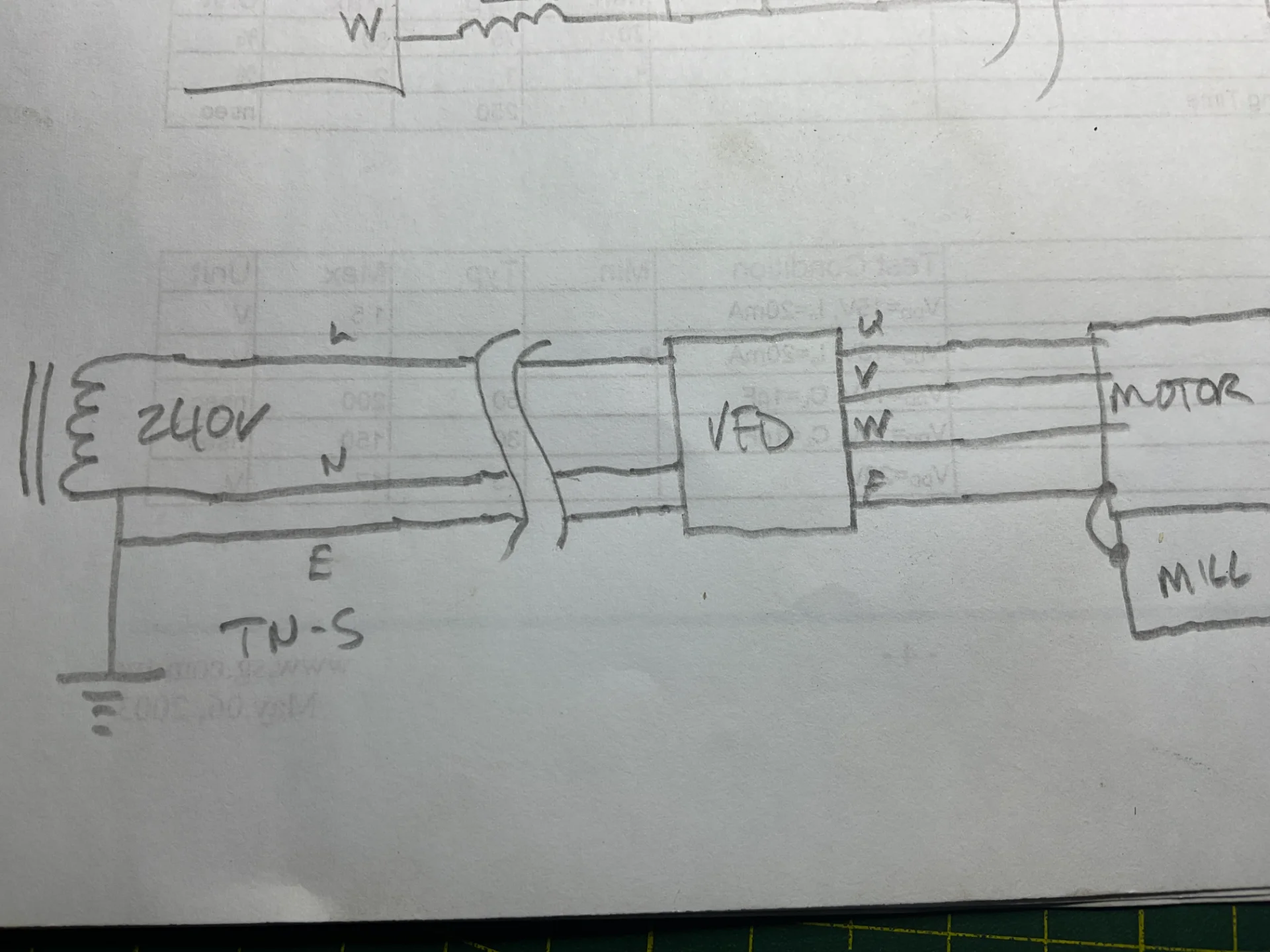

You also say "No neutral". The output of the VFD must somehow be referenced to neutral/ground. If it's floating your scope may have a hard time.
Thanks, the line trigger trick worked better, but the trace is either incomplete or slowly redrawn, presumably due to variations in line and VFD output frequency. Not camera-friendly.
This is a typical VFD topology. In my case, the input is single phase, and the motor in delta. It is mains-referenced, but there is no output neutral.

That's because it's not referenced to earth. Can't expect the scope to give you anything readable.
I would expect the 3PH lines generated by the VFD should each look like a 240 Vrms relative to the neutral input or ground.
Each line will vary between +340 V and -340 V.
You cannot view that with the oscilloscope using only the x10 probe switch.
5 volts per division, x10, over 8 divisions = 400 V total, yet you need twice that to show the whole ±340 V wave on the screen. Without more attenuation you will not see a whole cycle of 240 Vrms, let alone the difference between two lines.
In your post #35 you show stepped sine waves, but they are being clipped by the input amplifiers. The subtraction is clamping the voltages at the x-axis.
In dual trace mode the single beam CRO either alternates sweeps, or switches rapidly between the traces. You may need to take control of that dual trace mode.

In the USA 240 volts 3 phase would generally be delta with 240 between the corners of the delta. Typically one winding center tapped for ground/neutral but not always. Wye would be 120 volts hot to neutral.
The fact the he gets readings between the outputs of the VFD and ground that are not stable implies the output is floating. Wonder if that is configurable.

It was the multimeter measuring. The supply neutral is referenced to earth at the pole transformer, probably around 100m of cable length away, overall:

Looking again at the scope shot in #29, I was able to move the trace down and see the peak of that waveform, which would be +340V. This should be the same for the PWM waves, not counting voltage overshoot. It’s probably that causing the trouble.
I did experiment a bit - the traces shown (#29 and #35) are in single-trace mode, CH1-CH2, with CH2 turned off (you can see it’s in lowercase). Adding it in or out didn’t seem to make much difference, nor changing add/chop with it turned on.

This needs to be addressed before we go any further. Those measurements indicate the outputs are not referenced to earth. You say the power supplying the VFD is referenced to earth which is likely true. Until we know how the internal power supply of the VFD is designed we are somewhat in the dark.

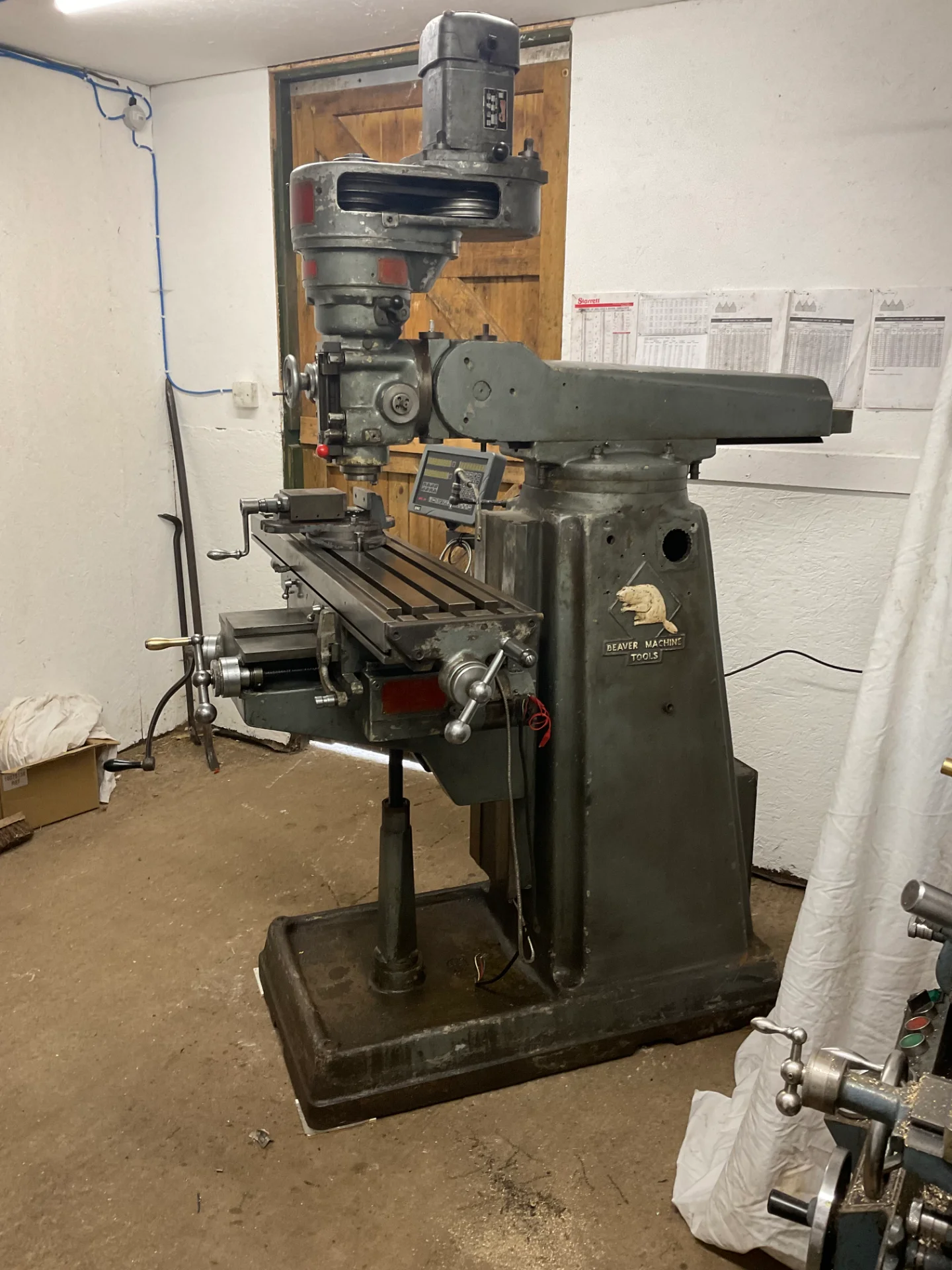

This, a 1961 Beaver VBRP:
The VBRP was the much improved version.
VB = Victor Balding, the founder and owner of Balding Engineering.
RP = Richard Prime, the machine tool designer, who redesigned the machine.
PAL was a smaller mill, named after Victor Balding's golden retriever.

Good knowledge! It’s usually described as a Bridgeport copy, although slightly heavier at 1.5 tonnes. Note very long bar in the picture, for shunting it into position.

If you insist, then. I’ve ordered the Rigol DHO804, which has some good reviews. Having four channels on the Fluke has been helpful, eg when scoping a switch-mode power supply - I can watch the feedback, oscillator, chip power supply and output voltage all at the same time.
Also, two cheapish 100x P4100 probes, which might come in handy for other things.
The wye incandescents gave a phase voltage of around 130 Vac, with the same sort of oscillation to earth. It might be something to do with the VFD’s EMI filters.
I assume the 130 volts was measured from the wye node to each VFD output? Sounds about right. You will probably not be able to makes sense on any scope with the voltage to earth moving around like that. I wonder what would happen if this wye node were tied to neutral through another incandescent or maybe a pair in series in case the voltage exceeds the bulbs rating.

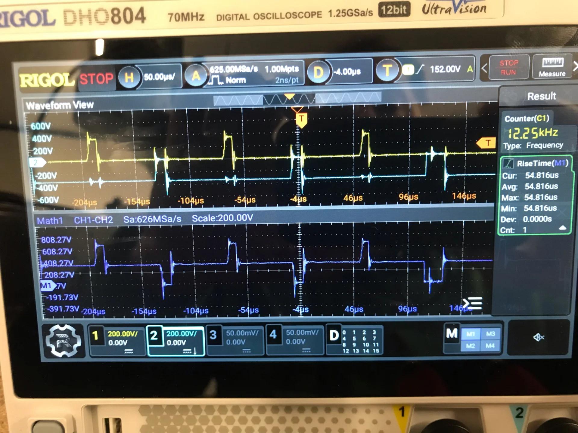

The Rigol has arrived, and I’m just getting familiar with it and waiting for the 100x probes. It’s very nice to be able to capture waveforms. For example, I can now tell that my ESR/inductance meter measures both quantities at 69.1, 7.2 and 1.8 kHz, just by rolling a waveform, freezing and zooming in.
Initial results with the digital scope are not quite as expected.
Using 100x probes and the CH1-CH2 displayed in the blue window, without filters:
With filters:
So, although the rise time is 10 us slower with filters, the waveform looks subjectively messier.
Edit: Looking at the pictures again, I’ve got it set on CH1-CH2, and then inverted CH2, which I think is a mistake. Will re-measure tomorrow.

During those observations, what 3PH load is connected, in Y or Δ, to the VFD ?
