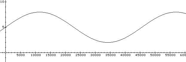

In a harbour, the equation for the depth h of water is h = 5.0 + 3.0sin(2π/45600)
where h is given in metres and t is the time in s. (The angle 2πt/45600 is in radians)

Question 2 should read
In a harbour, the equation for the depth h of water is h = 5.0 + 3.0 sin (2π t/45600)
For this harbour, calculate:
If you can find the side "a", then you can get "h" easily.
#2: Better check the minimum. Suggest you graph the sine function on your calculator so you can see how it goes. You can get a good estimate of the time interval between high and low that way, too. If you calculate the period of the sinusoidal, you can easily get the exact value for that interval. In sin(kt) the period is 2π/k.

If you graph #2, you will see:
In sin(kt) the period is 2π/k. Your k = 2π/45600 so you have
period = 2π/(2π/45600) = 45600. The time from one crest to the next is the period, 45600 seconds. Think about where the minimum is compared to the two crests. Check your answer by looking at the graph.

I don't get 45600 when I subtract a 1000 (initial) from 35000 (minimum point) - the difference between the two crests. Explain please.
I don't understand the equations you put forth?!
The first 2 crests are at about 11000 and 57000.
A crest is a maximum, the top of the wave.
Is the minimum = 35000?
So, how do I go about obtaining the time interval between high and low-water?
Yes, roughly 35000. 34000 would be better.
So, you've got a low at 34000 and a high at 11000.
Just subtract to get the time interval between them - approximately.
To get an accurate answer you must look again at the wave formula and calculate the period. Use that T = 2π/k trick I mentioned earlier.
I'm not sure what you mean by accurate here. I get answers at different ends of the spectrum:)
T = 2π/(2π/45600) = 45 600
Time interval = 34 000 - 11 000 = 23 000
iv. two values of t at which the water is 5.0m deep
(0,0) seeing that these are the coordinates
v. the length of time for each tide during which the depth of water is more than 7.0 m.
Readings from the graph.
Tide 1 app. 7 000s Tide 2 is app. 50 000
Good work! The 45 600 is the period, the time from high to high.
The 23 000 is an estimate of the time from high to low.
Do you see a relationship between the two? Look on the graph - how does the time from high to low compare with the time from high to high?
Still in the dark - adjust your estimate from 23000 to 22800 and try again.
Yes, the time from high to low is half that of the time from high to high.
All right! Take half of the accurate value you have for the period.
