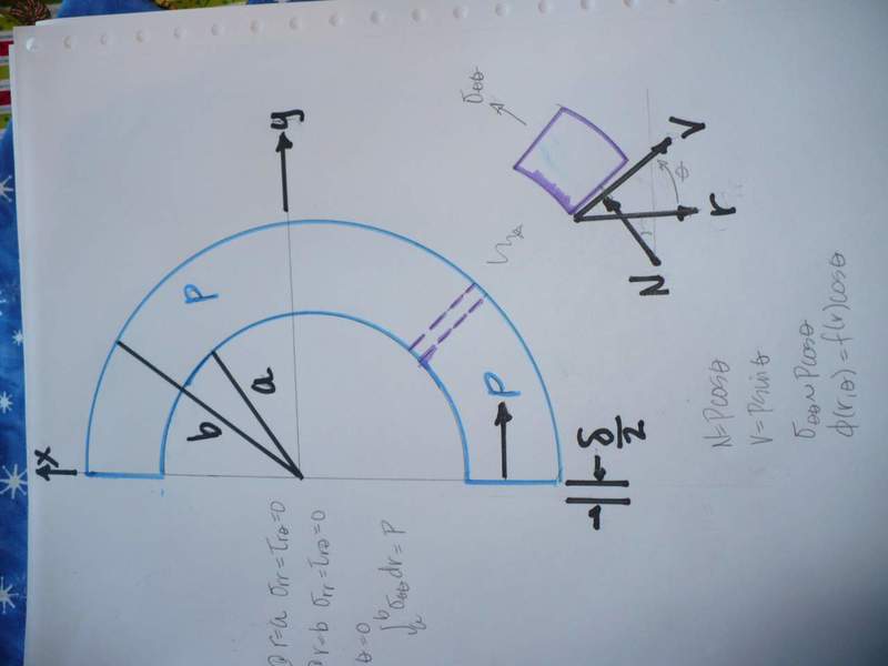

An originally complete ring made of linear elastic material (Young's modulus, E and Poisson's ratio, v) is cut by a saw. A gap, delta, is generated by a pair of forces, P. Determine this force, P. (Use Saint Venant's principle) Inner radius of ring, a. Outer radius, b.

I took an element at the top of the ring so that:
N = P cos theta
V = P sin theta
psi(r,theta) = 9Ar^2 + B/r + Cr + Drlnr) cos theta
sigma rr = (2Ar - 2B/r^3 + D/r) cos theta
sigma theta theta = (6Ar + 2B/r^3 + D/r) cos theta
sigma r theta = (2Ar - 2B/r^3 + D/r) sin theta
applied BCs such that @ r =a or b: sigma rr = sigma r theta = 0
@ theta = 0 P = integral from a to b of sigma theta theta dr
I solved for A, B and D. They all contain the force P that I am ultimately solving for though. So now I'm stuck!
@nvn~ can you give me any suggestions on how to proceed?

The attachment exceeds the size limits of the forum. Any suggestions??
This is the best that I could do! Hopefully you can see it...
L.Richter: Excellent diagram. I did not understand the solution in post 6. If this ring is not a thin ring, I am not sure how to solve it; but maybe someone like Mapes might have ideas. However, if we can pretend your ring is a thin ring, you could solve it as follows. I would say, ignore shear deformation and axial deformation, which are negligible.
r = ring mean radius,
θ = cross section location, measured from -x axis, 0 ≤ θ ≤ pi,
M(θ) = bending moment = P*r*[1 - cos(θ)],
phi(θ) = rotation of the ring,
y(θ) = ring horizontal displacement.
phi(θ) = [1/(E*I)]*integral[M(θ)*r*dθ].
y(θ) = integral[phi(θ)*sin(θ)*r*dθ].
Boundary conditions: phi(pi) = 0; y(pi) = 0.
After you obtain y(θ), set y(0) = 0.5*delta, then solve for P.
