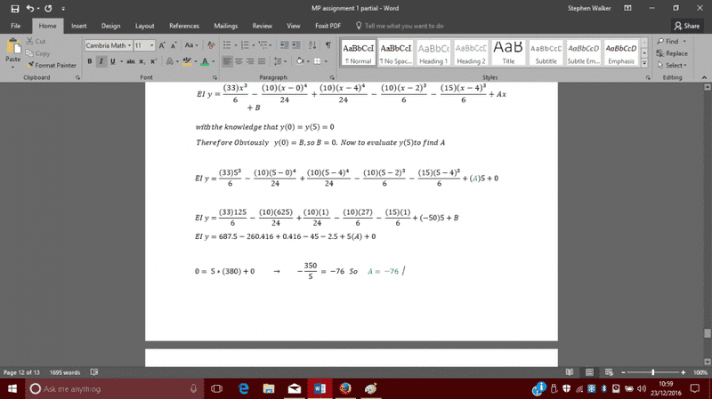

This is my working out for A when x = 5, and B = 0,
I am completely lost as to how I obtain the value for A when B does not equal 0, I would think A is worth a different value as x changes?
I presume I am plotting onto the graph for the value of B anyway?
Do I need to use the math methods for finding 2 unknowns or is their a much simpler way. Obvioiusly Understanding Calculus is not my strong point in all of this!
Thanks
A and B are constants, by definition. You correctly found that B must be zero in order that y(0)=0, then you found that A=-76 so that y(5)=0.
There is no more to do, you have the complete equation. Just sketch the curve and see if you get something like the graph I posted.

but what about the deflection values for 2,3and 4 meters as the question requires me to give results in 1 meter increments. Also how would I find out to what level the curve should drop to before it begins to climb back to 0? I would have thought they expect me to plot each point and then build a curve from the known results.
Just plug those x values into the equation.
You seem not to understand the statement that A and B are constants. Having determined what they are by considering particular (x,y) pairs, they apply for all x.
Think of it this way. Without knowing A and B, you have an equation which satisfies all the loads, but works no matter how high the two supports are. You can adjust each up and down independently, and the beam displacements will adjust to match. That is equivalent to varying A and B. In the actual set-up, y is defined to be 0 at the left support, and the right hand support is at the same height. A and B must have those values which give y(0)=y(5)=0.

So I think I have the correct method now by inputting my values for x into the formula for each point on the graph with the knowledge that A already sums to -76 for each value of x and B would be the graph plotting figure remaining in from the formula.

Not sure what you mean by that. Just substitute B=0 and A=-76 in your general equation for EI y as a function of x. Then evaluate for whatever values of x you want.
