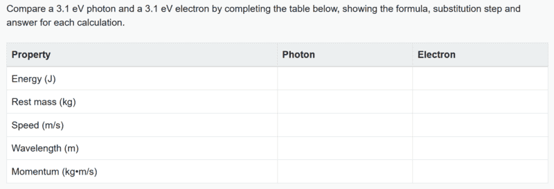

This is the original question:
My calculation is:
\begin{align*}
E &= mc^2 \\
4.96675 \cdot 10^{-19} &= m(299792458^2) \\
m &= 5.5256 \cdot 10^{-36}
\end{align*}
Better late than never... but you would have received much better help if you would have started with this !

The electron clearly has a total energy of 3.1 eV. So you have its energy (given), you have its rest mass, m (given in tables), and you can get its momentum from ##E^2 = (pc)^2 + (mc^2)^2##. You can get the speed from the momentum, and you can get the wavelength from deBroglie.
The photon also has a total energy of 3.1 eV. It's rest mass is 0 eV, its speed should be obvious, and you can get its momentum from ##E^2 = (pc)^2 + (mc^2)^2##. You can get wavelength from the Planck equation.
Why don't you fill in the whole table and post your reasoning? That will help us know what it is that you know.

Ok, I understand. Thanks for laying it out like this. I wasn't taught that momentum equation but it looks very useful. When you say "given in tables" for the rest mass, can I ask what you mean? The way I see it, I have two possible answers: a literature value from online (but I'm pretty sure I'm supposed to derive it myself somehow) or the value I got from E = mc^2, (which doesn't match up with the literature value). I'm actually starting to lean towards just using a literature value. Does "given in tables" mean a literature value?
a71cj34 said:
Additionally, can I ask how you know the 3.1eV is the kinetic energy and not the total? Is it implied in the question?
Yes, it is implied in the question. A free electron has kinetic energy. It may have potential energy if it's in a field. Here no field is mentioned, kinetic energy is all that the 3.1 eV can be.
I think you should give up the idea of deriving the mass from the given energy of 3.1 eV and look it up. The idea is to use the kinetic energy and the mass to find the speed. The expression that I invited you to derive in post #18 is $$K=\frac{1}{2}m_0v^2$$ which you knew already. Knowing the speed, you can find the momentum and hence the wavelength.
Repeat for the photon. If you look up its mass, you will find that it is zero. You can also look up its speed, if you have not already memorized it. Fill up the photon entries as with the electron and you're done.
