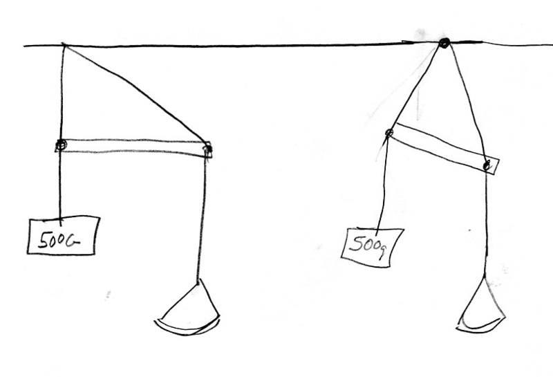

I have to design a scale to weigh something under 1kg and all am given is a yard stick, 10 ft of fishing line, a 500g known standard mass, and a protractor.
Use an angle measurement for weight. Don't just balance weights on a see-saw
I'm not looking for someone to do it for me. Just trying to figure out exactly what he means by using an angle measurement for weight. Any hints, examples, and pushes in the right direction would be appreciated.

Welcome to the PF.
Think about the two techniques for balancing forces that you use in solving many mechanical problems. One is to add up all of the forces on a body, and they sum to zero if there is no acceleration, right? What about summing moments (torques) on a hinged body? Same kind of thing, right?
So I would start with that, and think about how a mechanical beam balance works. BTW, the technique I'm thinking of does not require a protractor, it just requires the meter stick to be horizontal in balance. Does the solution of the problem require the use of the protractor?

A see-saw is a particular type of machine. You can avoid that type of machine by making it one-sided. Does that hint help? Please share your thoughts and efforts toward a solution of this question. The PF works best when you are talking out loud and trying to figure out the problem...
EDIT -- one more visual hint... What do you do when you step on a balance at the Gym to measure your weight. What do you move?

Not sure if this is what you were trying to hint at. I think it at least partially is. I will wedge one end of the meter stick into a wall and make that the fulcrum. The object of unknown weight will be placed at a point on this stick. The other end will be held in the air with the wire going up, around a pulley (possibly using protractor or finger as pulley), and back down to the hanging known 500g weight. Moment=Force x Distance. Sum of the moments = 0. I can figure out M2 from 500g, gravity, and d2 measurement. Then solve for the unknown mass knowing gravity, d1 measurement, and what M1 must equal for the system to be at rest. Thus we will move the unknown around until we find a position that leaves the counterweight unmoved. Sound like it will work? Did you have something different in mind?

How about something like this. As the weight to be measured gets greater, the angle of the wire from the vertical will increase.
Will the vertical wire stay vertical when there is no weight on the other end and the 500g mass in place under the vertical wire?
I feel like the triangle would be off vertical to begin with
The wire might not be vertical due to the yardstick being off to the side, but one could add another vertical wire when there was no weight to be measured. The idea here is that the weight could be measured by using the angle of the protractor located where the wires connected to the ceiling or other support.
So the angle that is being measured is the angle between the wire above the 500g mass and the vertical when there is no weight AND when there is weight?
That is the idea.
