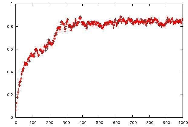

To understand the increase of entropy I suggest the following computer experiment:
Your data is an array of numbers from 1 to N. For example "7,1,5,9,8,1,2,3,5,1,8,9,2" or so. For a quantity called entropy you calculate S=-\sum p_i\ln p_i where p_i is the fraction of the numbers which is equal to number i. The "physical time evolution" will correspond to changing one number at a random position to another randomly chosen number. Now you can observe what happens to the quantity S and you will find that is almost always increases. This law is more precise the more and larger numbers you deal with.
If you understand this computer program, then you understand why entropy increases. Stating this in mathematical probabilitic terms this is a proof from first principles.
For demonstration I wrote this python program. Here is the program
Code:
from __future__ import division
from random import randrange
from math import log
import sys,os
P=[100,0,0,0,0,0,0,0,0,0,0,0,0,0,0,0,0,0,0,0,0,0,0,0,0,0,0,0,0,0,0,0,0,0,0,0,0,0,0,0,0,0,0,0,0,0,0,0,0,0] # all 100 particles in the first state
f=file("entropy.dat","w")
tot=sum(P)
for a in range(1000):
  for b in range(10):
    while 1:
      j=randrange(len(P))
      if P[j]>0: break
    while 1:
      i=randrange(len(P))
      if i!=j: break
    P[i]+=1
    P[j]-=1
    S=-sum((p/tot*log(p/tot) if p>0 else 0) for p in P)/log(len(P))
  print >>f,a,S
f.close()
os.system("gnuplot -persist - <<< 'plot [0:*] [0:1] \"entropy.dat\" t \"\"'")
and the output is attached.
So basically entropy has nothing to do with physics or dynamical processes. It is a purely probabilistic statement equivalent to saying "for coin tosses the most probable ratio of head to tails is 1:1".
