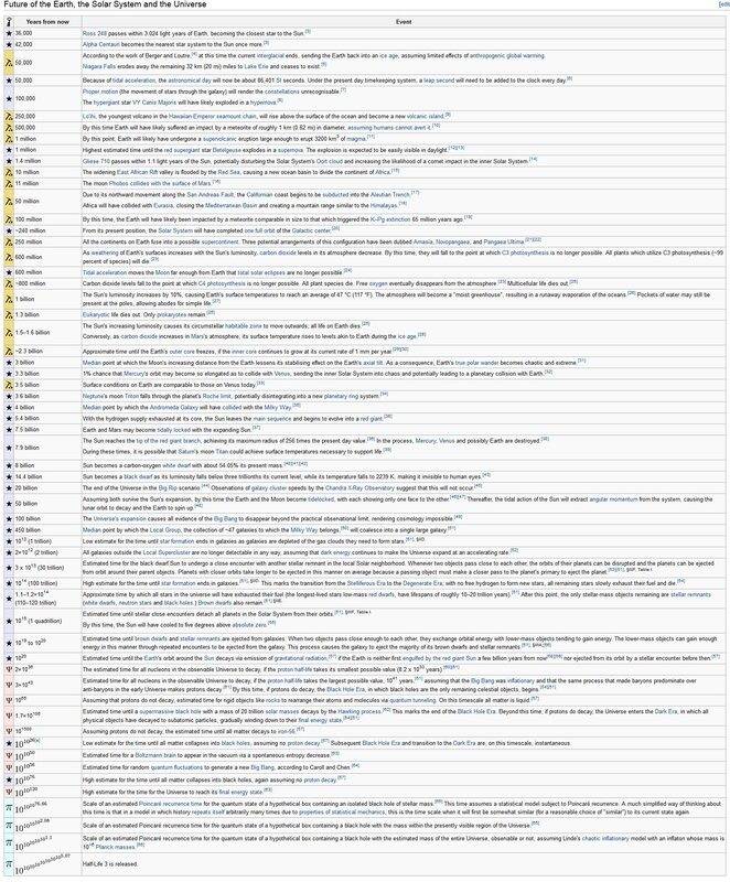

The point is that, for a system with many (say ##10^{23}##) degrees of freedom the typical Poincare recurrence time is much much larger than the age of the Universe. So during times which are relevant to human observations, Poincare recurrence cannot be observed. For all practical purposes the Poincare recurrence is irrelevant. Below I attach a table of typical time scales in physics, at the end you will see that Poincare recurrence times are the biggest (the last time scale is a joke).
