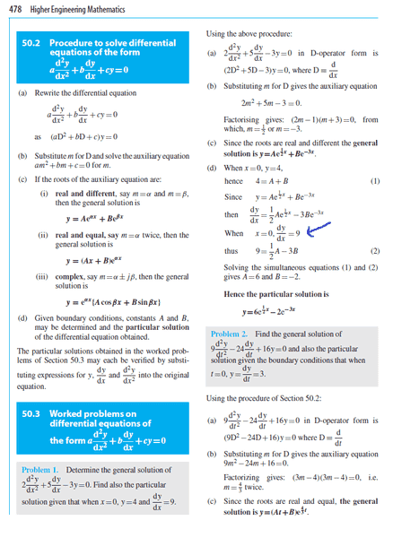

jayanthd Messages 16 Reaction score 0 Thread starter Jul 2, 2013 #1 I have a small problem in solving a Second Order Linear Constant Coefficient Differential Equation. Please see the attached image. I understand upto the point above the arrow. What I don't understand is how he got dy/dx = 9 Attachments mathde.png 44.4 KB · Views: 589

CAF123 Gold Member Messages 2,918 Reaction score 87 Jul 2, 2013 #2 Have a look at the problem statement again.
jayanthd Messages 16 Reaction score 0 Jul 2, 2013 #3 CAF123 said: Have a look at the problem statement again. Thank you very much. I had not seen that the slope dy/dx of the equation was given as 9.
