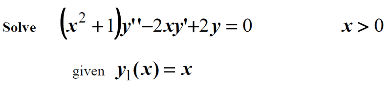

Fatima Hasan
315
Typeset problem: Solve (x^2 + 1)y'' - 2xy' + 2y = 0 for x > 0, given y1(x) = x.
Second-order linear differential equation written as y'' + P(x)y' + g(x)y = 0.

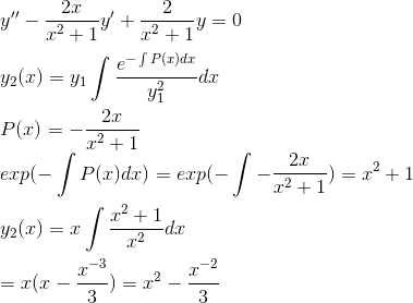

Handwritten-style typeset derivation solving a second-order linear ODE by reduction of order: y'' - 2x/(x^2+1) y' + 2/(x^2+1) y = 0, with y2 = y1 integral of e^(-integral P) / y1^2, P(x) = -2x/(x^2+1), giving y2 = x(x - x^-3/3) = x^2 - x^-2/3.
Can someone check my answer please ?

Hi Fatima:
I suggest you take your solution
y(x) = x2 - (1/3)x-1​
and calculate y'(x) and y"(x).
Then substitute these three functions of x into corresponding terms of the original equation. After the substitution, the resulting equation should be reducible to
0 = 0​
if your and answer is correct.
Regards,
Buzz
0 = 0
I didn't get this equation , can you tell me where is my mistake please ?
Your answer for ##y_2(x)## in the next-to-last line in post #1 is incorrect. Check the integration that you did.
##y_2(x) = x(x-\frac{1}{x})##
##y_2(x) = x^2-1##
##y(x) = C_1 y_1(x) + C_2y_2(x)##
##y(x) = C1 x + C_2 (x^2-1)##
##y_2(x) = x^2-1##
OK, now can you check that your solution is correct?
Got it , thank you.
