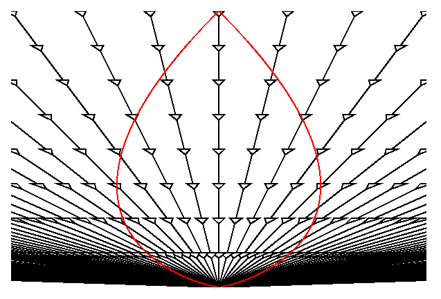

This is what makes the most sense to me but it doesn't fit with the idea that we can't receive a photon after a certain point.
[PLAIN]http://img545.imageshack.us/img545/66/53429694.png
right?
niceboar, I'm pretty sure it's not true that light has a coordinate speed of c in the type of coordinate system used in cosmology to talk about velocities of distant galaxies. For example, the red lines in this diagram (from this section of Ned Wright's cosmology tutorial) represent the past light cone of a given event at our location:

Well I think this statement might answer that
The time and distance used in the Hubble law are not the same as the x and t used in special relativity, and this often leads to confusion. In particular, galaxies that are far enough away from us necessarily have velocities greater than the speed of light:
I was wondering how you could reconcile an observation of an object moving faster than c with relativity.
Also if I had to guess I'd say it's more complicated than that. For one thing, the gravity of the galaxy would severely alter the spacetime around it I would think. So to an outside observer viewing the photon would see it going less than c? But I really don't know especially since x and t mean something different in this context. Still it doesn't make a whole lot of sense to me considering special relativity. The galaxy should be going less than c and the photon should be going c. So now I'm all confused I have no idea what this actually means.
So special relativity would say, no it is not expanding faster than c and an astronomical model would say it would?
