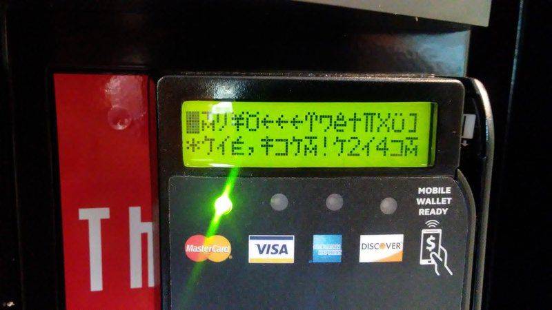

Nowhere near as graphic or physically destructive, but this is the display on a credit card reader add-on that was recently placed on some of the vending machines in our kitchen area at work. A couple weeks after they were installed on the vending machines, a few of them ended up with scrambled displays (no, we are not in Japan). Would you trust a credit card reader to work for you with a display like that? o0)
