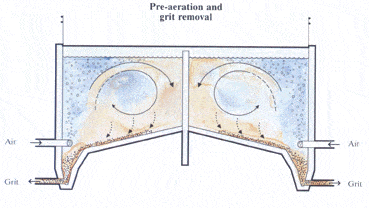

I'm doing some online research on fluid flow in waste water treatment. One of the problem I'm trying to find information about is how can visible particulate matter be separated within a liquid. I saw the following picture:
What fluid concepts are going here that allow the grit to be separated (apart from gravitational forces)? Is the process related to turbulent flow?

Same as how dirt swirls about in the sink when you wash your hands.
The motion of the fluid pushes stuff around.

Any motion in the fluid can shift particulate matter about. Circulation is famous for sorting particles though: see "panning for gold". Why would you expect otherwise with all the examples in Nature around you?
In this case it's more that light particles stay in suspension longer because they are well light ... easier for the convection to lift.

What is shown in your picture is some variety of vortex separator . The principle is well known .

Thank you Nidum! I googled vortex separator and got precise information about this subject!
