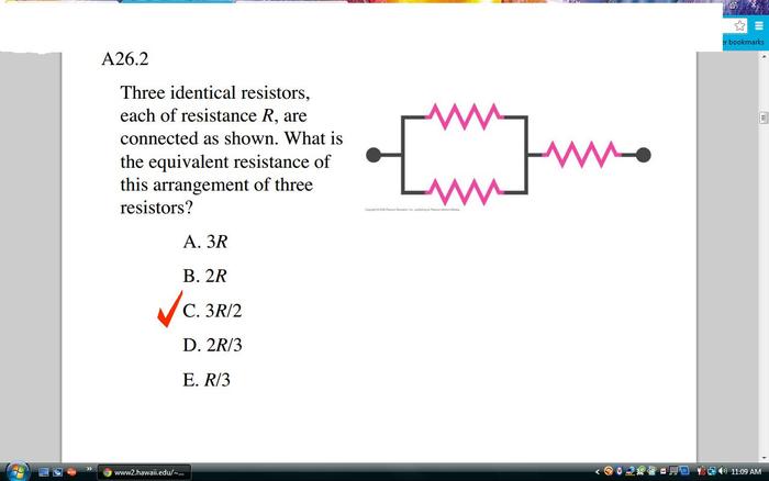

What I did was I knew that the their are two resistors in series
1/req= 1/R + 1/R = 1/2R
req= 2R
Where I get confused is how do I include the other resistor since I believe that it is in series?
The two resistors on the left are in parallel , that is the current splits up through the two branches before going through the last one.
Wow my addition was off... I figured it out, it is supposed to be 2/R and since like you said it splits up the total resistance would be req=R/2
R/2 +R = 3R/2
Got it.
