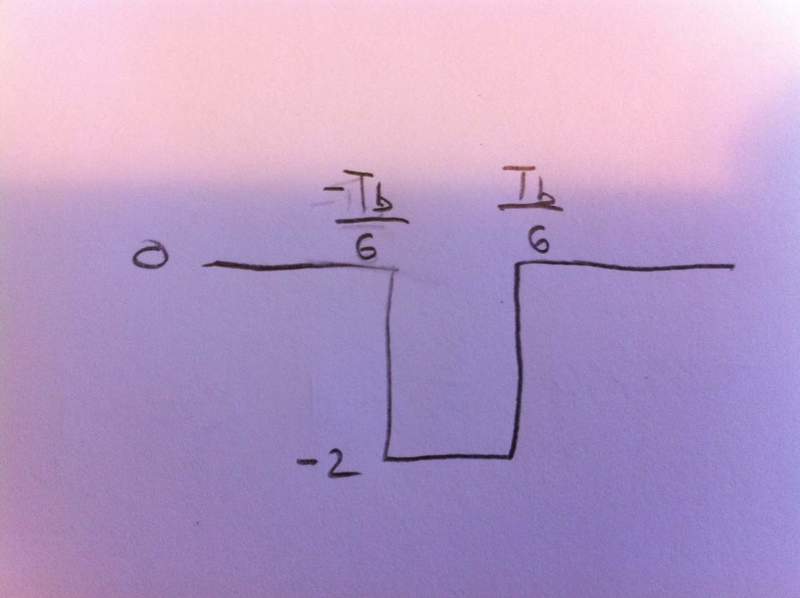

Im having some trouble setting up this problem.
##x(t)## is a polar signal with random binary data. The data is independent from bit to bit. ##P(0)=P(1)=\frac{1}{2}## Assume ##a_n=+/-1##.
The fundamental pulse shape is attached.
I need to find the Power spectral density of x(t)
$$S_y(f)=\frac{|P(f)^2|}{Tb}$$
Ok so as i mentioned I am having trouble setting up this problem. From the fundamental pulse shape I can determine that my pulse width is ##\frac{T_b}{3}##
Im not sure how to treat the ##P(0)=P(1)=\frac{1}{2}##.
I think I need to find my ##x(t)## and calculate the Fourier transform of it ##x(f)## or ##p(f)## in my formula above. Then square it and divide by the pulse width. If this is correct. What my ##x(t)##? How do I go about finding it from the information given.
Any ideas?

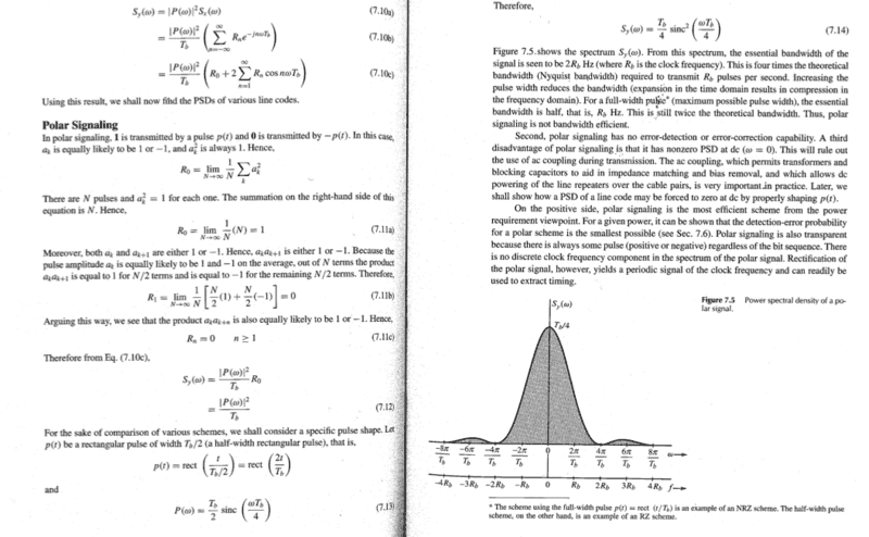

Good!
I can see now that there is a mix-up for the symbol P.
The symbol P in your problem statement has 2 different meanings.
In the statement P(0)=P(1)=1/2 the symbol P means the probability on either a 0 or a 1.
In the power spectral density formula ##S_y(f)= \dfrac{|P(f)|^2}{T_b}##, the function P(f) is the Fourier transform of the pulse p(t).
Furthermore, in your last attachment, an example is given for polar signaling (7.13 and 7.14).
In this example they use a rectangular pulse of width ##T_b/2##.
I believe you need to redo this example with a rectangular pulse of width ##T_b/3##.

The extra information identifies the problem as a polar NRZ signaling problem with white noise binary data.
In particular it's not unipolar, nor (alternating) bipolar, nor RZ.
That's why you can reapply the example, since it has the same classification.

This is what I did. Keep in mind i just used ##x(t)## instead of ##p(t)##.
##x(t)=rect(\frac{t}{(\frac{T_b}{3})})=rect(\frac{3t}{T_b})##
I used a table of Fourier transforms to find ##X(f)## I've shown the pair below. This is the same form the text uses from what I can see.
$$∏(\frac{t}{\tau}) \ \ → \tau sinc(\pi ft\ \tau)$$
so I end up with ##X(f)=\frac{T_b}{3}Sinc(\frac{\pi f T_b}{3})##
Then to calculate ##S_y(f)=\frac{|X(f)|^2}{T_b}## I end up with ##S_y(f)=\frac{T_b}{9}Sinc^2(\frac{\pi f T_b}{3})##
Yes. Very confusing. But more or less correct for p(t).
One small issue: the pulse in your attachment is negative.
So you would have ##p(t)=-\text{rect}(\frac{3t}{T_b})##.

Yes. That is correct, although the result for P(f) should be negative.
The result for ##S_y(f)## is still the same.

I see in my text there's a section that talks about the PSD and power.
##x(t)## is a power signal and ##X_T(t)## is an engergy signal. So the PSD is ##S_X(f)=lim_{T→ \infty} \frac{|X_T(f)|^2}{T}##
and the power is ##P_X=\int_{-\infty}^{\infty} S_X(f)df=2 \int_0^{\infty} S_X(f)df##
I know ##S_y(f)=|P(f)|^2 S_X(f)## I already have ##S_y(f)## can I just plug it in and solve for ##S_X(f)##?
Now I am confused between the diference of ##S_y(f) \ and \ S_X(f)##
Thanks again for the help
##x(t)## is a power signal and ##X_T(t)## is an engergy signal. So the PSD is ##S_X(f)=lim_{T? \infty} \frac{|X_T(f)|^2}{T}##
Good!
That does not look right.
How did you get by it?
As you can see on page 8 of your pdf, the signal ##x(t)## is a convolution of the bit values ##a_n## and the pulse shape.
In the frequency domain a convolution becomes a multiplication.
$$X_T(f) = P(f)\cdot\sum_n a_n e^{-j2\pi f n T_b}$$
The second part is the Fourier transform of the bit values ##a_n##.
In other words, your ##S_X(f)## already contains ##P(f)##, so it makes no sense to multiply ##S_X(f)## yet again with ##P(f)##.
Your ##S_X(f)## is the same as ##S_y(f)##. Yet again just another choice of symbols.
You may want to make a list of concepts with their corresponding symbols as they vary from text to text.
The DC power of the signal would be ##S_y(0)##.
I like Serena said:
Good!
I agree. Its doesn't make sense that's where I was getting confused.
I understand. Thanks again ILS!
