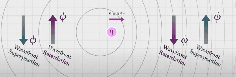

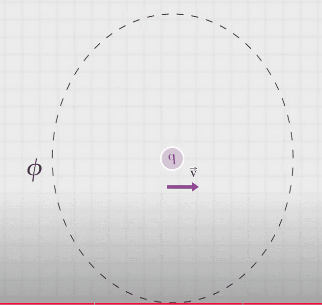

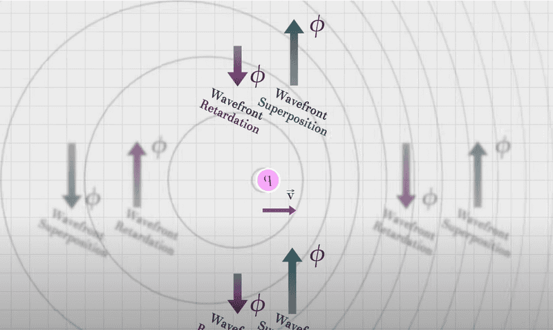

1) What is the shape of equipotential surfaces of the Liénard–Wiechert potential for a uniformly moving charge in the lab frame in the x-direction, like behind(x=-r) and in front(x=r) of the charge? Is the value the same as in the static case, Coulomb potential at x=r?
2) Is there some kind of asymmetry in the x-axis or is it symmetric like shown at fig. b?
Fig. a:
Fig. b:
Any pictures of the moving potential would be appreciated...

as maybe I should just actually read the book...so on the x-axis at θ = 0 and θ = pi, the potential is actually the same as the static one.
So, I guess the video is actually correct in showing this here:
right after this, this picture is shown:

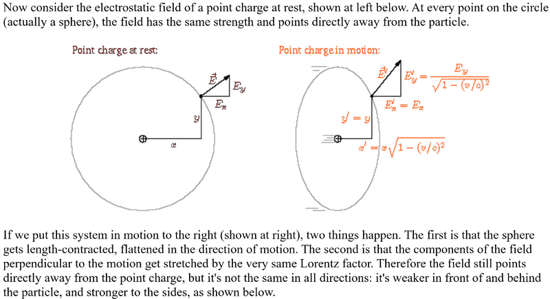

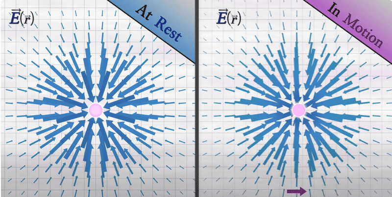

but this picture is wrong at this time (@17:39), because we here see a moving spherical symmetric field equal to the static one both in the lab frame (indicated by the velocity vector)...
The potential isn't uniquely defined - it depends on your choice of gauge. So the first picture from the video may or may not be correct. It's inconsistent with Griffiths' 10.51, which is manifestly mirror symmetric about a plane perpendicular to the x axis and passing through the charge, but that may not necessarily be wrong.
The electric field, however, is uniquely defined. It is spherically symmetric in both frames, but should differ in strength by a factor of ##\gamma##. It's not clear from the diagram if the arrows are different lengths, or whether they are intended to be, but to my eye neither looks less spherical than the other.
