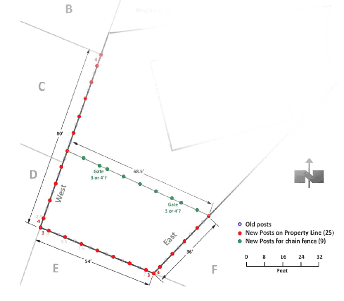

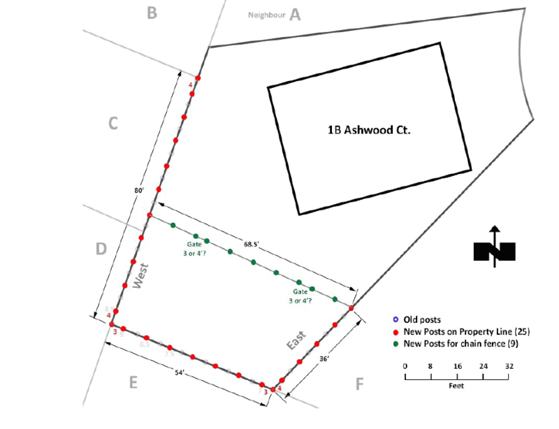

I am dividing my backyard in half, one area will be fully enclosed by a 6+ ft fence, in anticipation of a pool. Three sides of the enclosed area are on the property line (red posts) and will be enclosed in a standard wooden privacy fence (shared with neighbours). The yard itself will be divided by an interior fence (green posts) so that we have a play area (in anticipation of a pool).
That's all back story. Only the interior fence is of concern right now.

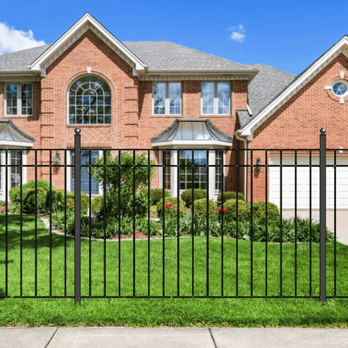

I'm looking for something just slightly less hideous. Even this is perfectly fine:

I am having a contractor come in to do all the post holes. He will place them eight feet on-centre across my yard.
One big advantage of a chain link fence is that finishing the fence is not dependent on the exact placement of the post holes. They can be off by a lot and it makes no difference. Chain link doesn't come in sections; it coems in rolls, and you just rooolllllll it on to the posts.
Any other type of fence I can find (such as the example above) seems to require exact post hole placement. I assume the way one would do this is to dig the post holes at the same time as erecting the fence panels, i.e. post hole 1, panel 1, post hole 2, panel 2, etc.
Am I correct in this assumption?
Or, is it possible to
a] have my post holes pre-dug by a contractor, and still
b] panel it any other way than with "Frost"-style chain link?

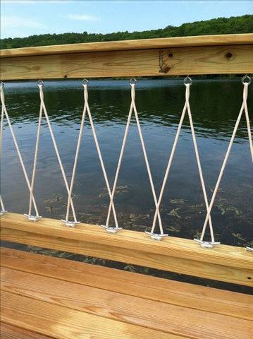

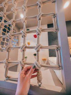

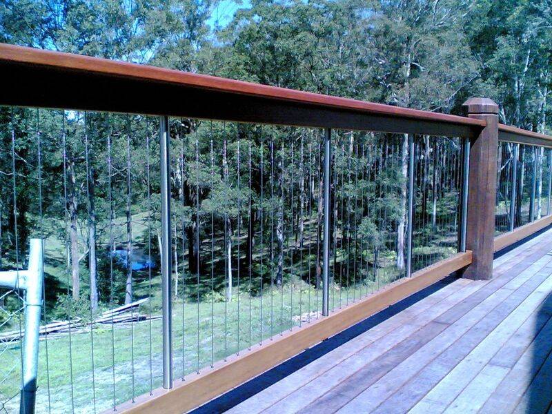

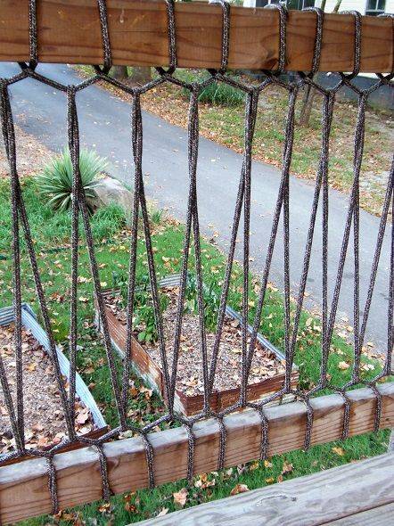

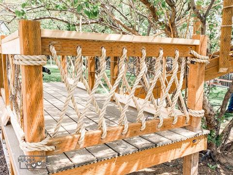

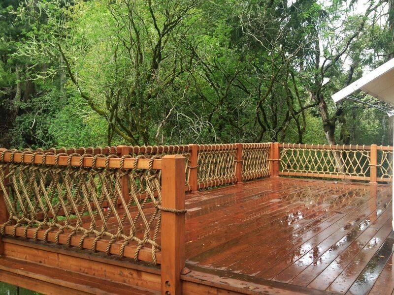

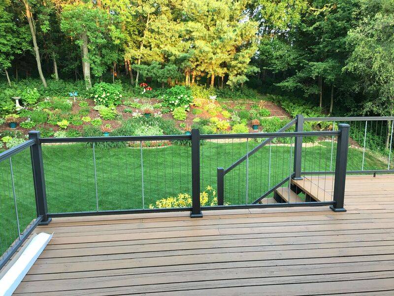

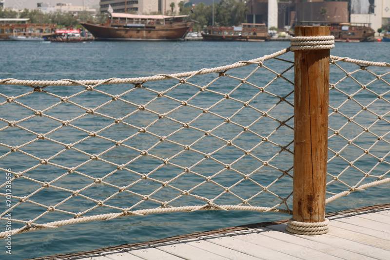

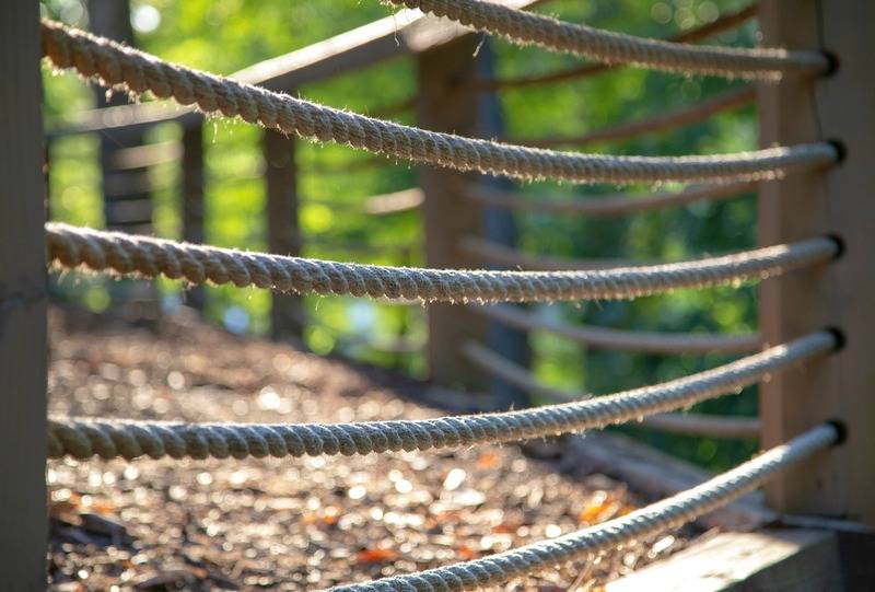

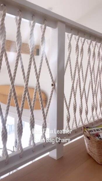

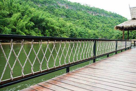

But, given your criteria, I would look into steel cable or rope fences. Some ideas:

jack action said:
I don't understand why you would want to install the posts before knowing what kind of fence you want.
It's more about time crunch. If we don't act soon, we are about to get a Frost fence, because things are coming to a head with the contractor who will be setting the posts. (I don't want to hold him up, because the fence is only phase one of the backyard spring project. We hope to complete phase two (the pool itself, by end of June.)
Anyway, since we all hate Frost fences, I'm looking to see if there are any alternatives before I commit to the contractor to drop in the posts.
Except for #2 and similar ones
most of those styles are inappropriate for fences intended to be safe for small children. They all have various ways children can get body parts caught.

Good point. Most likely Dave already has done that, but it does bring up the point that one of the designs he initially posted probably doesn't meet code for pool fences (since skinny toddlers can probably make it between those bars):

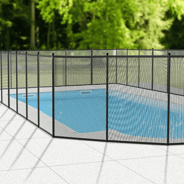

Based on that line of thought for ideas both 'pool fence' and 'child safety net' gave some decorative, not 'frost fence' looking results, both in permanent and removable variations... I guess some company offered ones should be adequate to be used as template?

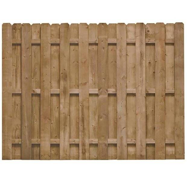

The second criteria was designs that could be erected after setting the posts (like you can with Frost fencing). For example, this wood section (already rejected) is probably a challenge to fit in a gap that's over or undersized.
However, after some feedback and reflection, I am more comfortable now that many fence styles have a means of adjustment to account for imperfect placement of posts.
