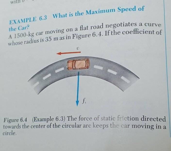

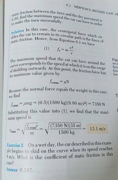

Shouldn't this be kinetic friction instead of static friction!?
I know how to solve the problem but the thing is I'm confused!
I think that it must be Kinetic friction because the car is moving
I hope you understand my point!
F_s =u_s*N
In what direction is the car moving ? In what direction is the car skidding/not-skidding ?
What I'm asking about is why is STATIC FRICTION not KINETICK Friction?

Kinetic friction occurs when two surfaces slide over each other; there must be relative motion between the two surfaces in contact. When a tyre rolls, there is no sliding between the rubber and the road (unless wheelspin or a skid occurs).
It is useful to think about what would happen if the car going in a circle hit a patch of perfectly smooth ice (where there is no friction).
Just because an object is moving does not mean that kinetic friction is necessarily at play.
Place a small book on flat table. Push hard down on the book with your hand and move your hand horizontally so that the book slides across the table. Both static and kinetic forces of friction act on the moving book. Static between your hand and the book because the book and your hand do not move relative to each other; kinetic between the book and the table because the book and the table move relative to each other.
How does this difference between the two apply here?
